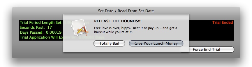

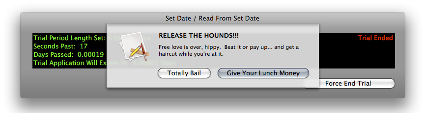

Sample Code Attached
so i managed to figure out how to do this... it took me all night, but i'm glad i have at least something to work with now... it's perhaps not the most optimized way of doing this, since the NSTimer is running every second, but it seems to work (and there are no memory leaks!)
files are attached. open in xcode and build the project yourself. the app writes a date/time stamp file (.txt) to the desktop, and employs NSTimer as a listener while the app is running. times are displayed in the window to show it works. in real world use of this code, the file with date/time stamp would be a hidden file written somewhere on the user's computer, and maybe not as a plain text file as Yeroen suggested earlier.
i would appreciate feedback if anyone has any thoughts or suggestions.
[EDIT] i found that my attached code wasn't stopping when the time ran out because of my original if statement, so i changed it to: if (daysUsed >= 0)... now it works properly... the updated attached file is now set at 0.0002 days (which is about 19 seconds or so) so clearly anyone who wants to use this will have to change that number to the amount of days they want their serial to last (IE:15 for fifteen days)... finally, depending on how long you trail is (or isn't), it's really not that necessary to run the timer ever second... once every 5 of 10 minutes should be fine, or even once an hour while the app is running.
