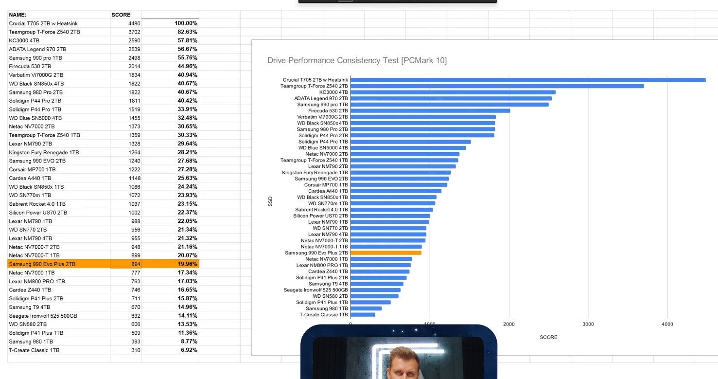

There's a PC Mark stress test this called drive consistency test in which the 990 Pro is vastly superior and I have no idea what the test does.
A YouTuber, who I generally have trust issues with because he has a tendency of making mistakes during his reviewing process (I remember his CPU cooler test in which the biggest / better ones were performing worse than the smaller ones to his surprise, because he forgot to remove a plastic part on the socket lever which the bigger heatsinks were touching lol and never addressed it afterwards even though plenty of people commented on it), ran the rest compared to lots of other current drives:
I'd love to see how they both compare thermally and which one is the better drive for creative apps and for Pro Tools while keeping the temps in check.
From the benchmarks, both seem to trade blows and the SN850X seems to perform really well in direction storage benchmarks for games which means it's the better drive because that requires a lot of data streaming of lots of files in a short amount of time?
