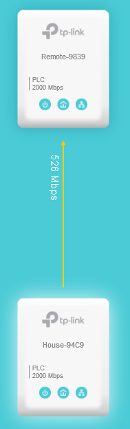

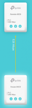

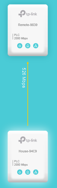

The TP Link docs for mine said not to plug the adapter into a power strip. Instead, plug the adapter into the outlet and the strip into the adapter.
The app should show you the link speed:
