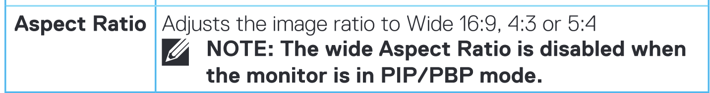

I’ve just looked at the manual for the Dell S3221QS: there is no option to display lower resolutions at actual size with black borders around them ("1:1"). So if that’s what you want, you may have to get a different monitor.

It probably means that if you run the monitor at a lower resolution, it will always upscale the image to fill the screen, introducing blurriness. If you want lower resolutions to be displayed "as-is" without any upscaling and the blurriness it introduces, you need an aspect ratio setting of "1:1", so that they're displayed centered with black borders around the edges.
