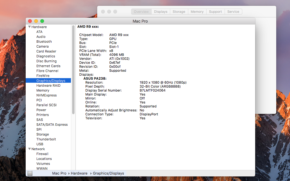

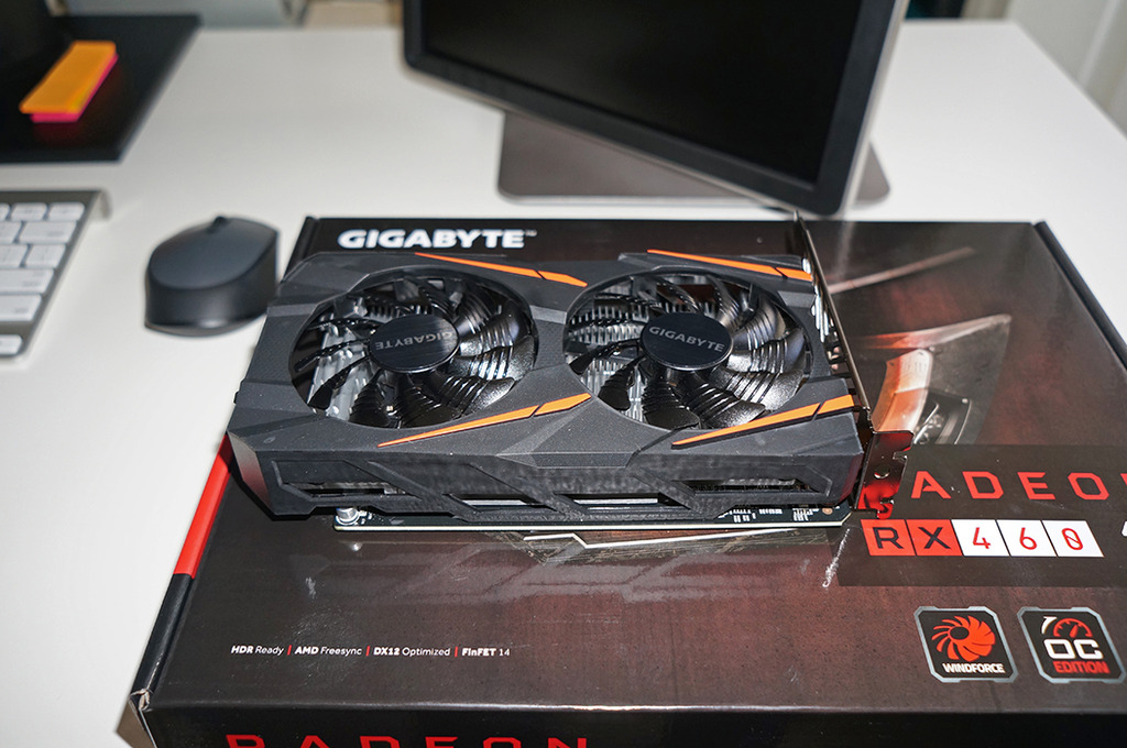

The Gigabyte RX 460 4GB VRAM worked flawlessly for me OOB. Supports Metal; No hacking; has boot screen (I see the progress bar; is that the boot screen?) No PCIE cable required. So, consumes less power than HD 7950 with only .7 less TFLOPS performance than the HD 7950 (RX 460 = 2.2 TFLOPS; HD 7950 = 2.9 TFLOPS). Also, has more VRAM than HD 7950 and is listed at $130 for the 4GB version.

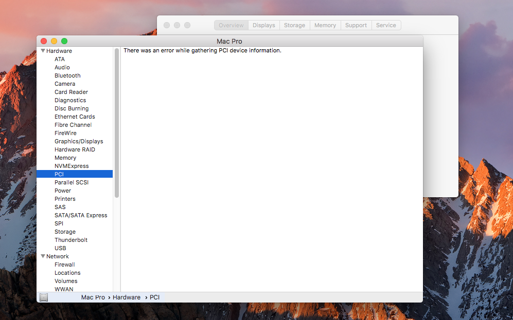

The only caveat with the RX 460 is that you need Mac OS Sierra. And, it's an "unofficial card," so future updates might brick it or something. And, System report doesn't report it under PCI. And, the name for it under "About this Mac" is "AMD R9 xxx 4096 MB," which can be cosmetically altered, I think. You also need to get the Gigabyte one as other RX 460's won't work for some reason....

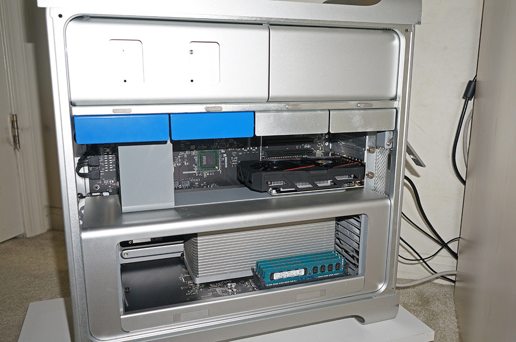

Here are some pictures:
