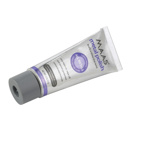

Any recommendations? A few micro-scratches here - nothing big. Just want something that I can use every few weeks to buff it up. Also fancy restoring my 70-year-old Omega to some of its former glory.
I have also had good results from MAAS
I would probably only use a dry jeweler's polishing cloth if I wanted to remove microscratches. Cape Cod cloths have a cream in them which would be hard to keep from getting into any openings or crevices. In any case, an abrasive polishing is going to remove metal, and you don't want to do that frequently. A soft cloth or even real chamois for removing greasy fingerprints and the like is going to be gentler. And sometimes it may best to just live with the little scratches as added character 😀
