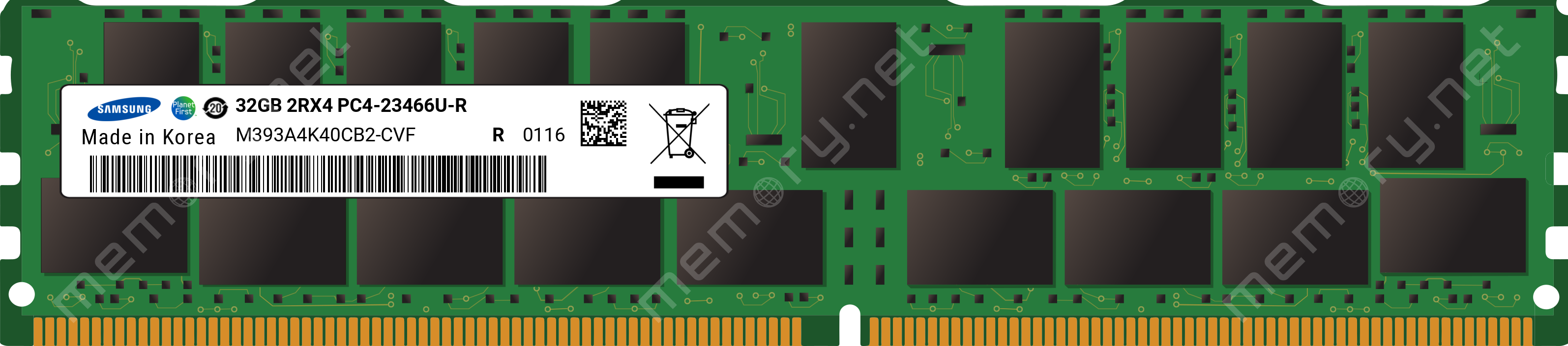

M393A4K40CB2-CVF this is the article number of the sticks that I bought. I got them from a German mac memory Webshop, but I’m sure if you enter this number into your local google you’ll find good offers.
Looks like the 32GB version of the ones I ordered. They are $132 at Memory.net:-

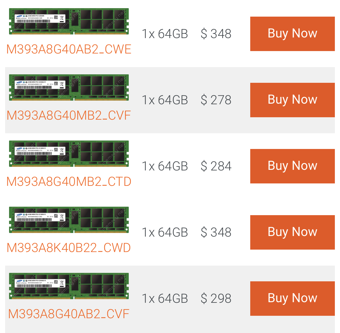

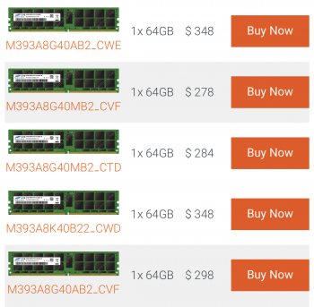

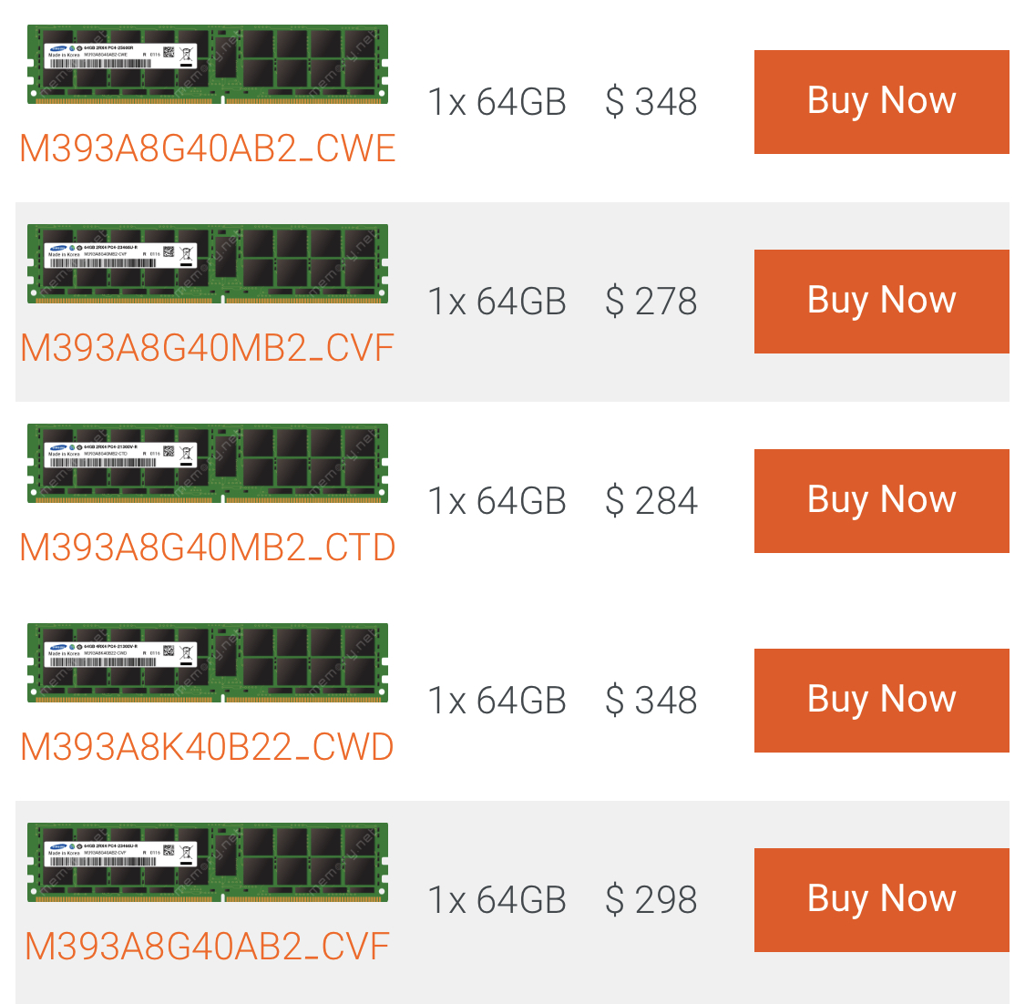

I’m not very sharp when I comes to exactly what RAM does. Can someone explain why these 5 Samsung RAMs are all different prices?
You can just type the SKU into Google - the top one at $348 is faster at 3200, rather than the 2933 that the Mac Pro uses.
