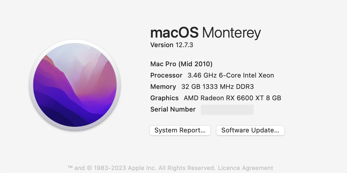

Alternatively, if you were going just for a GPU to use on 5,1 then I'd suggest looking into RX6600XT 8GB and flash that card so it is compatible. It's my preferred option:
