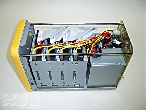

I have a small server type item and it takes ide drives, i want to get some terrabyte drives and install them with sata to ide adapters.
There is not a lot of room in the top as the container around it slides on it and the ide ports are on the top of the item where the lid slides on,
i need to get some sata to ide adapters that either have flexibility or are long cable type adapters?

What specifically is this "server-type-item", or do you know? Maybe pictures for us to see what exactly it looks like and what you are describing? I wasn't able to get a good mental picture. Rackmount?

hey everyone, thanks for the inputs:
here is a link for the item:
http://www.geek.com/articles/xyzcom...-machine-terabyte-storage-appliance-20050930/
pic is on the inside where the drives go, a bit of space for the adapters🙂
with the pic i included i believe i may need to add sata cables in order for the adapter to lie down over the top of each drive, thn plug into the adapter itself?
possibly like this:
http://www.cooldrives.com/sainexca22ex.html
just ordered 4, should be here in a week and i will test this set up out!!
Don't forget you will also need power adaptors. You shouldn't have any LBA issues with this device.
To be honest, I think you're far better off taking the money you will be spending on adaptors and buying something more recent. Aside from the cost and potential headaches, this device is very slow. In testing it rarely breaks 5 MBps. If you're using this for backup, I think you're going to be very disappointed. This device was slow 4 years ago. Even the very cheapest of today's NAS boxes are 2x as fast.
If the NAS devices out there don't agree with your budget, there is an equivalently priced option. For the money you'll be spending, you could buy a used PC, install FreeNAS, and have something that will run circles around this.
