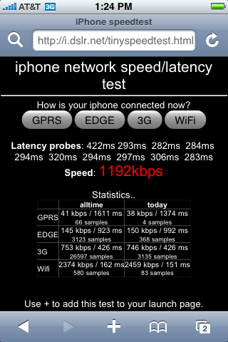

[url]http://i.dslr.net/tinyspeedtest.html
I feel like this is probably the most accurate, as the speeds it reports are usually in the middle of the other 2.
I use this one also... the results seem to be less all over the place but also still seem to correlate well with day to day changes in subjective performance....
Tried this and its pretty accurate and corresponds to other checks i have done with my wifi connection. Recommended by mua 🙂

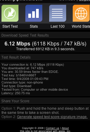

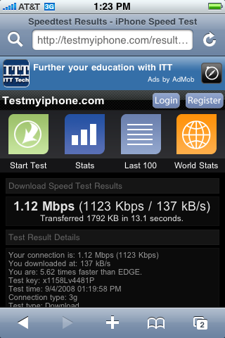

http://testmyiphone.com/
I have a theory that this site is owned by AT&T. If I test 400kbps on inetworktest.com, I get 1400kbps here. Hmm...maybe inetworktest.com is owned by Verizon. 😉

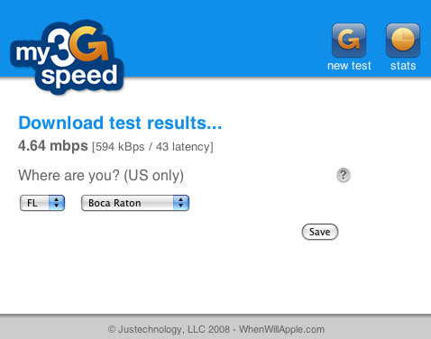

I agree with this. I just recently built an iPhone speed test site called My3gSpeed (http://my3gspeed.com) and was checking results against DSLR and Test My iPhone. The results I get from My3gSpeed always seems to be very close to DSLR with TMI giving faster results. Another thing I noticed is the math isn't quite right on the TMI site. If you go from kbps to kBps to mbps by the time you get to mbps you are getting a higher number than you should based off the original kbps number.

No my math it correct. Everything is divided or multiplied by 8.192 the correct number to do it by.
There is no point to from kbps to kb/s to mbps, you would have to be stupid to do it that way.
The easy way to do it is kbps * 8.192 = mbps and kbps / 8.192 = kb/s
Thats the correct way to do it, and thats the way I do it. My Math is correct.
My test will give the most accurate results for the iphone because I built it so it would be the most accurate, the reason for making it was so it would be the most accurate. I choose the best data center, and a sever that could handle 50,000 tests a day so your results wouldn't be in accurate because of the server load.
Here is my 6mbps connection through speedtest.net, then through my site, my3gspeed.com

kb/s to mb/s
Odd. I always thought that b=bit, B=byte, k=1000 or 10^3, and m=1000000 or 10^6.
And so to convert from kb/s to mb/s one would divide the former by 1000 because 1000k=1m.
Here is the method I use in converting from any one unit to another compatible unit, applying the identity property I learned in high school algebra. To convert from one unit to another, multiply the quantity and unit by a conversion faction that is equal to 1 with the input unit in the denominator and the output unit in the numerator. Do the arithmetic treating units as variable (for example k/k=1) and you get your answer.
3000 kb/s * 1m/1000k = 3mb/s (I am multiplying the input by 8b/B which is 1 so I didn't change the value of the input)
400 kB/s * 8b/B = 3200kb/s
I often don't remember the conversion factor between various units, but I usually can recall the base conversions with which I can construct a logical conversion that yields the desired unit.
Is my logic flawed?

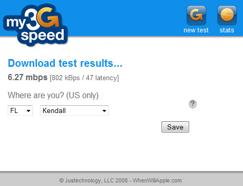

I mainly just did this as a fun project to learn how to make an iPhone website and building my own speed test, but I definitely want it to work correctly and give good results so thank you for the feedback.
It's strange you got such different scores from my3gspeed and speedtest. I live like an hour south of you and am using bellsouth (att) DSL as well. Speedtest.net gave me 6450 kb and mine 6570 kb [EDIT using the new 8.192 thing I learned this would be 6570 kb and not 6416 kb].
My server is located in Chicago which I figure is a pretty good place to have a server for the US. The other big server location I know is texas, but Chicago is good for my Canadian friends 🙂
