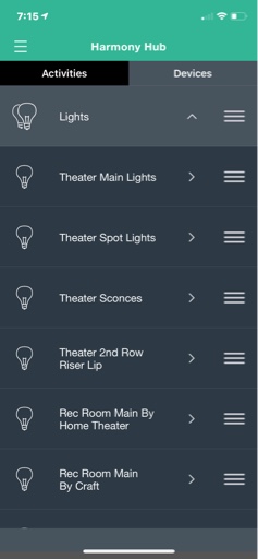

I’ve got the whole basement on them, thru Apple HomeKit, then into Harmony. In the dedicated HT I can use the Harmony elite remote, or the smartphone app, or Siri to control lights
