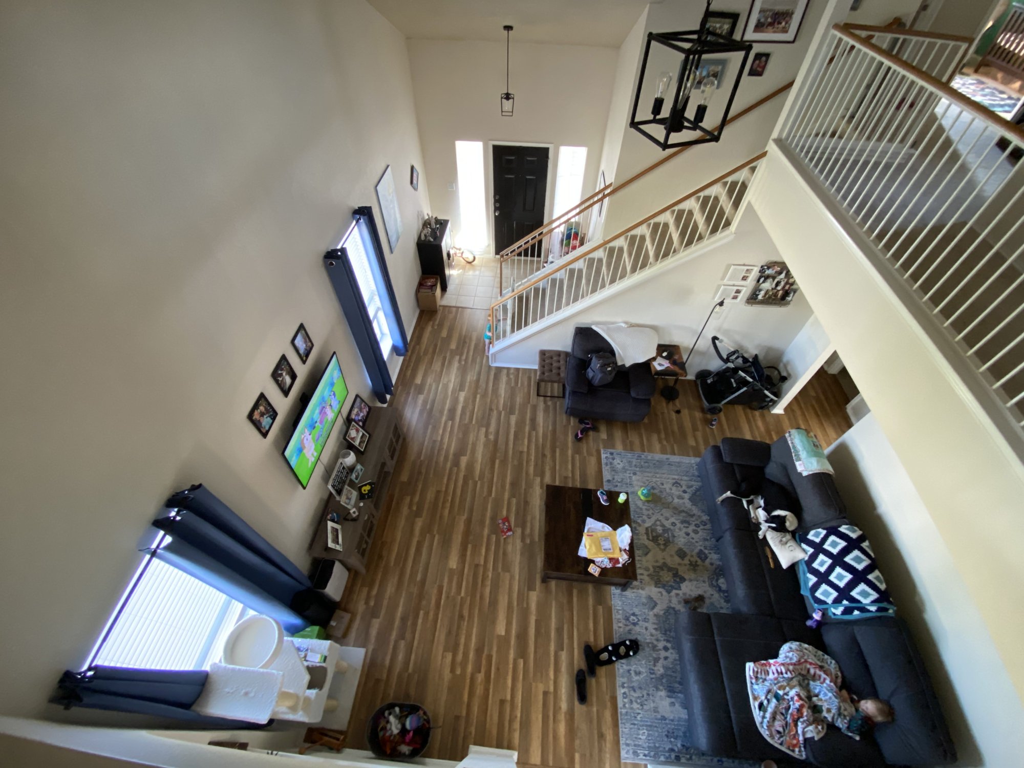

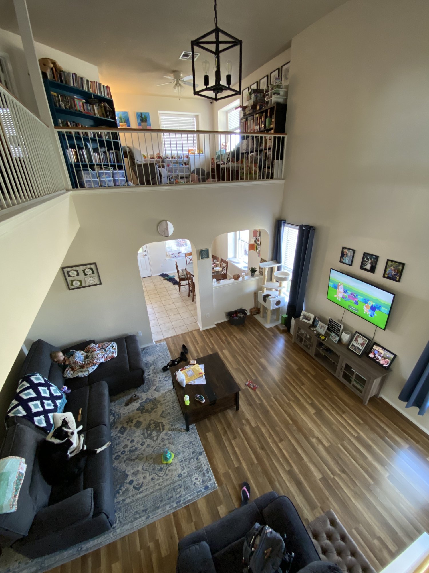

Thanks all! Our living room is very oddly shaped; it is open to a second story loft/hallway, the viewing area (couch) is under an overhang, the room is semi-open on the left to the kitchen and on the right to an entryway... just acoustically horrible. (I tried to take some photos, but don't know how much they help...)
So this is why a traditional 5.1 surround sound system isn't really feasible, because to run wires in the walls would be downright impossible. In addition to this, we have young kids, so we want something that they can't fiddle with and also we don't want a lot of volume because it would wake them up.
Given all of the above, we are not looking for "OMG this is the best surround sound ever", we are looking for "better than the built-in TV speakers". We are approaching 40 years old and we want to hear voices a bit easier (the latest TVOS should help with this), and just overall want something that sounds better than we have now. Price point is because we were hoping to ask for the soundbar as a Christmas gift.

With that new information and pics (and further clarified preferences), I’d still suggest catching Arc on sale/refurb and/or chip in towards your gift or get someone else wanting to give you a gift to chip in.
That enormous vertical space will beg for a great soundbar if you want one. And even if you want low volume most of the time, there will be other times that you might have reason to crank it a bit. Room-filling sound is significantly challenged if you go small here.
Idea 2: buy Arc yourselves and be gifted an Era 300 or two for surrounds. Black Friday and/or refurb can yield significant savings on them.
Idea 3: Sonos isn't the only game in town (just a very good one for anyone wanted a soundbar-based system). Another good option is the kind that includes a wireless sub that then connects to the surrounds. You can put the soundbar where you expect and then bass and surround sound is wireless beamed to a subwoofer module and 2 surround speakers connect to the sub. Sub is usually put on the back wall for this so that there are no wire runs left & right of the TV (Sub generally sounds just fine ANYWHERE in a room). A good suggestion that is high rated by many sources is Polk MagniFi MAX AX or Nakamichi Shockwafe Pro Bluetooth 7.1.4 Channel, though only the former and Sonos directly supports Airplay 2. A workaround for the latter is to lean on Airplay to the AppleTV to then play from the Nakamichi speakers. Again, Black Friday is likely to yield better pricing and/or, be gifted a portion of something like that Polk and then add the rest yourselves.
Idea 4: if you would rather build yourself the traditional Receiver + "dumb" speakers setup, your pictures imply that you could possibly run your wires for the rears around the far right wall (and stairs) to get back to the seating area. There's lots of products to hide these including hollow baseboards and/or various kinds of strips (example) that sit above or in front of existing baseboards and basically blends right in. Maybe you can get through the underside of the stairs? Or if you have a basement, maybe you can send a few lines down, across and then up again behind the seating area? Harder than a soundbar? YES. But if you can find a way, it will likely yield very best sound.
Again, a good starter- since you are thinking soundbar anyway- would be to go with only front left, front center & front right speakers, immediately giving you better stereo separation than ANY soundbar choice at any price. Then you can always add sub and rears later. Traditional is not necessarily about "loud"(er) but just best. And in a room with that much vertical (open) space, it would still likely be the best option for great sound- loud or quiet. Else you are asking a LOT of any soundbar and even more so of speakers like HPs and similar.
One more note: little kids grow fast and may want to crank it themselves in a few years. Teenagers tend to like their audio LOUD. Speakers- if you choose good ones- will likely still be your speakers when they are adults. Consider what you want in 2034 and 2044 vs. only 2024.
All that offered though, if the selection quality bar is dropped to "better than TV speakers", anything will likely be better. TV makers usually cheap out on built-in speakers. So just anything should sound better than the TV.

For a room that size, I would recommend the Samsung Q990D. That will set you back about $1500 but it's the best value for great home theater audio imo.
If you are absolutely set on spending less than $500, I would go with others have said - try to find a refurbished Sonos Arc, or go with the Sonos Beam 2. The Beam 2 is an amazing sound bar at the price point.
If you watch a lot of TV/Movies, don't go with Apple HomePods. You want an actual soundbar with a center channel or else hearing dialogue will be difficult.
Looking at your room I think an Atmos setup is goign to be hard due to the high ceiling and openings to the left and right of the screen. This means that upfiring solutions from the front may not bounce down off the ceiling to your seating position and any side-firing speakers to give a surround effect (such as the Arc) will likely have limited effectiveness.
It sounds from your comments that you're not overly fussed about a good Atmos effect and are mostly interested in "better than TV speakers.' My recommendations would be to trial a Sonos Beam 2 and maybe the Bose range. The Beam 2 is a 3.0 speaker that uses digital processing to imitate and Atmos effect without upfiring speakers, which might actually the best option for your setup. You can also add a Sub and rears over time if you see fit. The Bose soundbars have a good reputation, but I haven't heard them.

After hearing the Sonos Beam in my open living room, I couldn't possibly recommend it for yours. The openness of your ceilings and the crappy app Sonos has currently, I think you'd be severely disappointed with the overall experience.
My vote would be for a soundbar with wireless rears and wireless sub within your $500 price point. Maybe Vizio or something like that.
