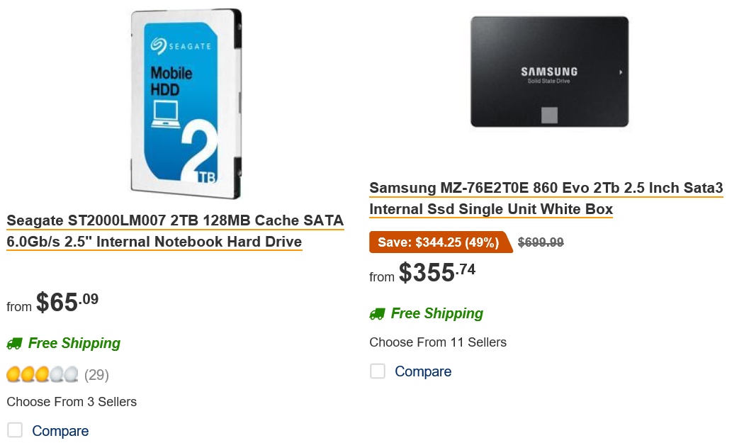

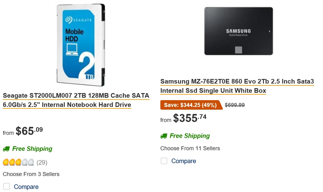

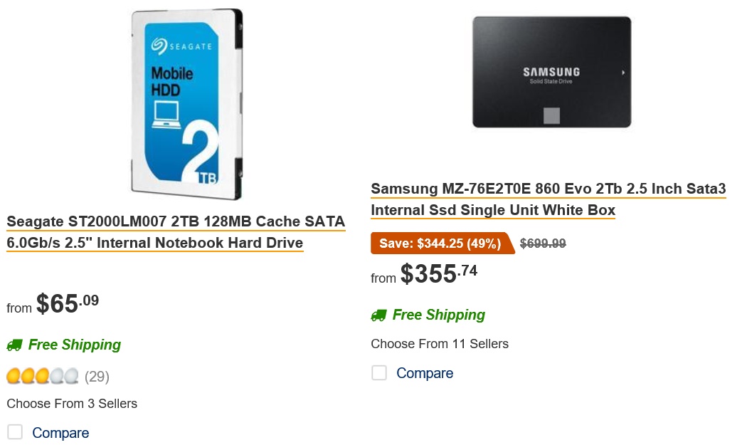

For active data, definitely most of the time.
Sometimes, however, the application is compute-bound. If the CPU can only process 100 MB/sec - paying five times more for SSDs isn't wise budgeting.
For archiving or seldom-used data, hard to justify SSDs.
Reactions: barmann
Not hearing the annoying spinning & clicking sounds is the only justification one needs. 🙂
