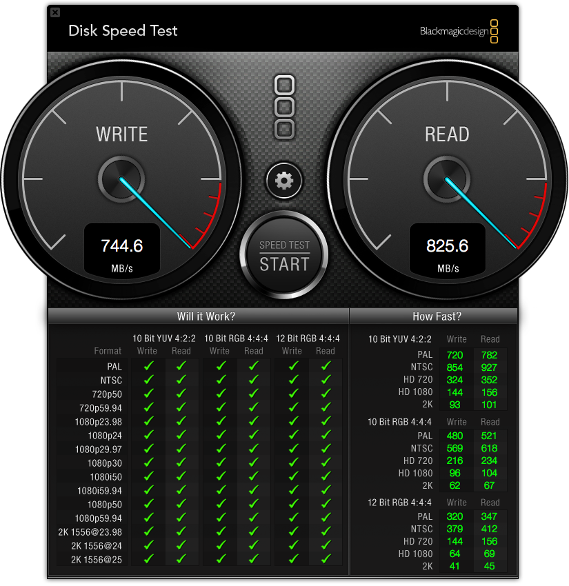

My results with 830's... again I am using a Softraid build to preserve the trim command.
http://softraid.com/press-2011-12-20.html
SSD TRIM + Enhanced SSD/Thunderbolt Support: The SoftRAID 4.2 driver greatly enhances support for SSD operations, including TRIM support for third party SSD drives. SoftRIAD is the only solution for Mac OS X that supports TRIM for RAID volumes. Internal testing with SSD and Thunderbolt shows the SoftRAID driver can achieve over 40,000 I/O’s per second. With the increased availability of SSDs and the introduction of ThunderBolt disks, we wanted SoftRAID to take full advantage of the performance of these incredible new technologies.
PS Sorry about the plug, it's just that I had a hard time figuring this one out so I thought I'd throw the link out there.
Thank you analogkid for that screen capture, nice results.
I wonder if there's any performance benefit from using SoftRAID instead of Disk Utility when setting up the RAID strip. At $129 is not a specially cheap software.
When I get my hands on both the Mini and the SSDs I'll test them 1st with Disk Utility and then with the trial version of SoftRAID to see if makes any difference.

Pretty impressive ... what computer are these in and how are they attached?
2011 server, 8GB 1600, dual 256 drives all internal.
