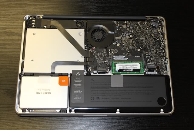

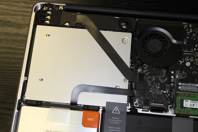

The nimitz caddy is great. I just installed it in mine two days ago. The drive is very secure in that caddy (4 different screws attach it to the caddy) and then it also fits really well into the optical bay with the same screws (3 or 4, cant remember) that apple uses for the optical drive. I got mine from the link in the first reply. He also sells an optical drive enclosure for ~$25 which i purchased and im very happy with. Fits perfect and is very secure (includes 2 screws to keep everything in place and together).
As for storage I have a 128 GB crucial M4 and store EVERYTHING but my movies on it. Those go on the optibay drive. The reason being is that I listen to music quite often so I'd rather only have my SSD turned on and my HDD unmounted and not using battery/making noise. I'm not too worried about too many writes to the drive as I found a thread detailing the amount of writing that needs to be done to an SSD to damage it and it was astronomical. Could vary from drive to drive, but it made me feel better.
This is the thread: http://www.xtremesystems.org/forums/showthread.php?271063-SSD-Write-Endurance-25nm-Vs-34nm
The last page has people checking back in after a LOT of data has been written to the WHOLE SSD and it showing only a 1% drop in health.
Looks awesome, could I ask you to let me know how the screws fit with that one please 🙂 Thanks
Just got it today, fits great. There is a little metal tab piece you need to remove from your optical drive and transfer it over to the Nimitz caddy. The place where I purchased the Nimitz caddy (ayagroup) brought (2) screws to reattach the little tab removed from the optical drive over to the Nimitz caddy. The (2) screws you remove from the optical drive are the same as those included with the kit. After review, The ones that came included with the Nimitz caddy are slighter longer. Figuring how they were included I decided to use them and save my apple ones. For reference they are the (2) little black screws. Other than that I recommend threading them (just screw them in) into the Nimitz caddy before transferring over the little tab your remove from the optical drive. Reason being, the pre drilled holes on the Nimitz caddy are ever so slighter smaller. This really is not big deal just present the screw in the pre drilled holes and use your screw driver to screw them in. Very very very little resistance needs to be made to thread the hole literally a hair larger. Since the Nimitz caddy is made out of a very pliable aluminum it is done very easy. Over all I am very happy and it works as intended and a fraction of other competitors caddys. The hard drive fits very securely and I feel comfortable to have it in the caddy. I went with a 750GB Western Digital Black Scorpio. While I was at it I also added 8GB Corsair RAM purchased off amazon for $44.00. Here are some pics of the Nimitz caddy and RAM installed.
