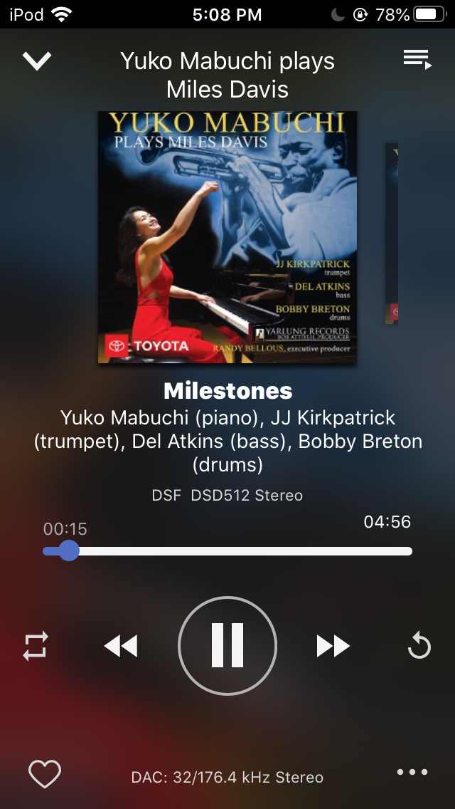

Yes, DSD256 playback should not be a problem. Roon should install as long as you have the latest OS X that is supported by your iMac. Check Roon's requirements though maybe it still supports 10.13 High Sierra IIRC. Just for the record, my iPod Touch 7th gen with an archaic A10 Fusion chip can play DSD 512

My DAC's USB module is self powered rather than getting the 5V 1A requirement from the iPod Touch, but it doesn't charge the iPod (wish it did though). I use the Lightning USB 2.0 CCK (not the 3.0 version with extra lightning port). You should use the 3.0 version with a power bank to power both the DAC USB module and your iPod Touch. A 30 feet USB cable is not recommended as the USB cable certification allows that feet as max. 6 feet IMO is what would the max recommendation be for USB audio.
