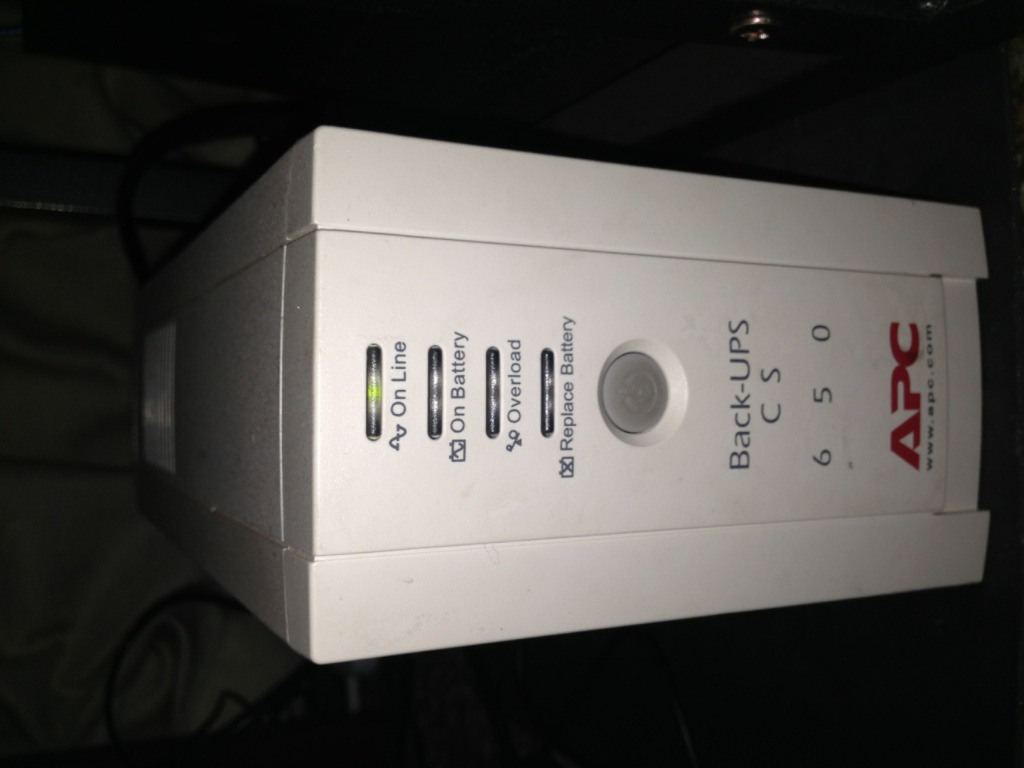

I am very much following up on this discussion. I have just bought the recent iMac 27". I tried to power it using this attached APC 650VA Back UPS and it would not start. Plugged it direct to the utility power socket and it sprung to life. So this pure sine wave theory is very much relevant. Maybe if users can list up the specific APC brand and part number that are compatible with this iMac? ImageUploadedByTapatalk 21364731199.562176.jpg
Sure, I am using an APC ES 750 with absolutely no problems. I have my mid-2010 iMac, Time Capsule, and router on the Battery Backup side and my MBP and printer on the Surge Protection only side.
