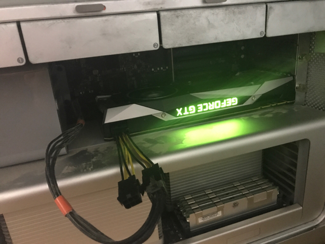

Okay, so I updated to 10.12.4....
Installed the web drivers and the Cuda drivers.... Installed the video card.... Hooked up the 6+6 to 8 pin power cable mentioned above.... and I'm getting a black screen.. Any help would be greatly appreciated!
Should both of the 6 pin tips be connected to aux power on the motherboard?
Yes, I do need to dust out my tower...
Yes, you need BOTH 6pins connected.

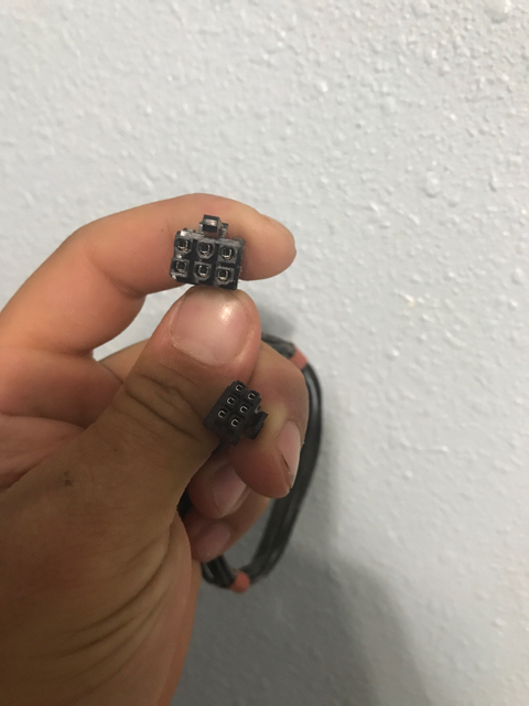

Okay, so here is a pic of my 6 pin cable. The smaller end was connected to my motherboard. Is this just called a mini 6 pin to regular 6 pin?
The smaller one is the mini 6pin. Plug that onto the logic board. Plug the other end (the 6pin) into your dual 6pin -> 8pin cable. You should connect all 3 cables (2x mini 6-> 6, and 1x dual 6-> 8) to properly power the card.
Okay, thanks!
I have ordered the cable.
Depends on the cable's price. If you have to order one anyway, you may consider order a dual mini 6 -> single 8pin cable.
This cable is useful, if you upgrade to another GPU later, with another single 8 pin (female)-> dual 6+2 cable, will allow you to install most of the high end GPU.
