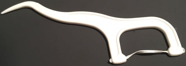

What you're probably seeing is meaningless dust/lint on the far end of the port - as long as the connector still clicks into place, you don't have to worry about that. Eventually, pocket lint may build up at the bottom of the port and maybe it will keep the connector from clicking into place. To clean out that lint, I recommend using a thin, flexible, plastic pick (like the tooth pick/flosser I've shown below. Be very gentle - just enough to dislodge the lint from the bottom of the port.
Do not use the SIM tool - it's too stiff, and not well designed for the task.

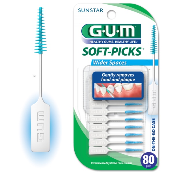

The best and easiest thing to clean ports are these. The rubber is "grippy" and picks up all lint. The rubber is soft and flexible so you won't damage anything. I also use these (very gently) to clean the speaker grills.
Great idea. I have soft picks similar to these so I'll give it a try.
