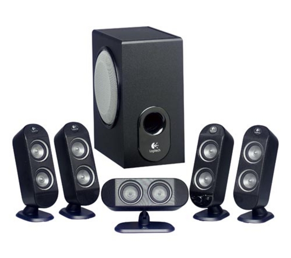

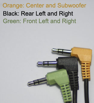

I have an older set of 5.1 surround sound speakers from Logitech that I'd like to use with my Mac Pro, however the Mac Pro only has one port for audio out other than the Optical. The Speakers only have the three RCA? plugs in the colors Black, Green, & Orange and I'm not sure how to get it so that I can use all the speakers.
The Speakers:
The Plug:
Is there a compatible Soundcard I can plu into a PCI slot or is there another, better way to set this up without the use of a receiver/amplifier.

So much bad advice in this thread... ugh...
1) ANY program in OS X can output 5.1 just fine. WoW and SCII both do 5.1.
2) The M-Audio 5.1 card is plain PCI and does NOT work in a Mac Pro.
3) An optical cable/TOSLink cable will not work because his speakers do not have digital audio in.
The Firewave is probably your best bet, although it does not work in Boot Camp.

Thanks for the concise summary of the thread. Seeing as the FireWave device is no longer available via regular retail, is there any other device that performs about the same functions? or is there a converter box that allows me to route TOSlink from my Mac Pro to my speakers hooked up to the converter?
Maybe this Product from Teufel will do it ?
Sorry for the german link - i found no international - but there are pictures of the backside of the decoderstation. i have one here in use connected via toslink to my mac pro and pc. you can buy some adapter cables for converting the cinch to 3,5mm for a few bucks.
