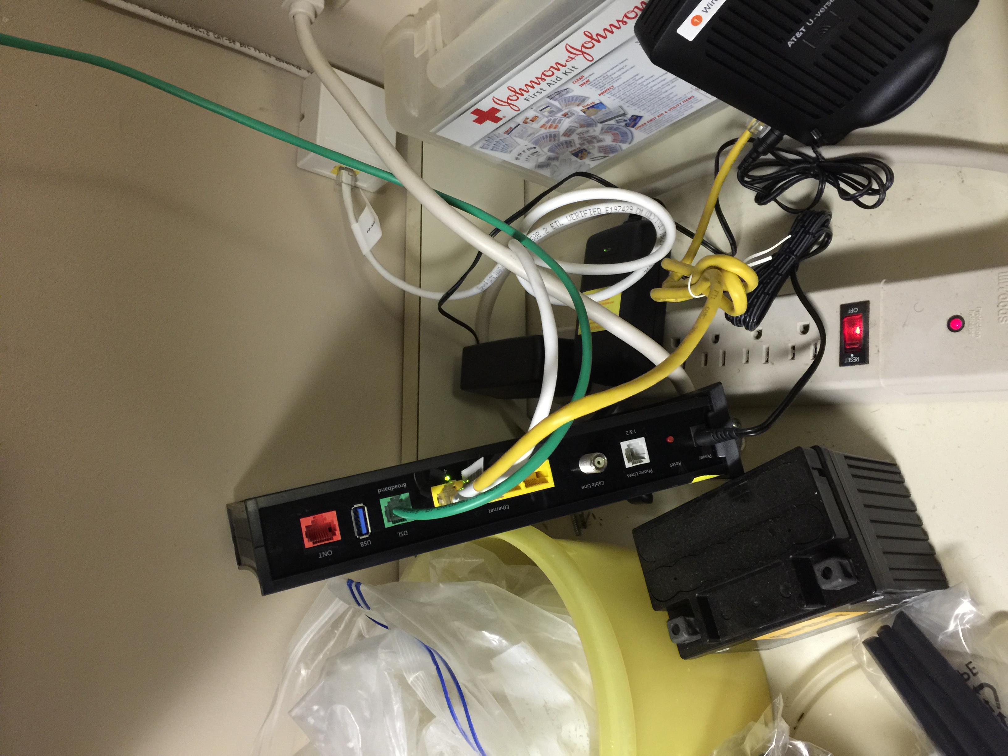

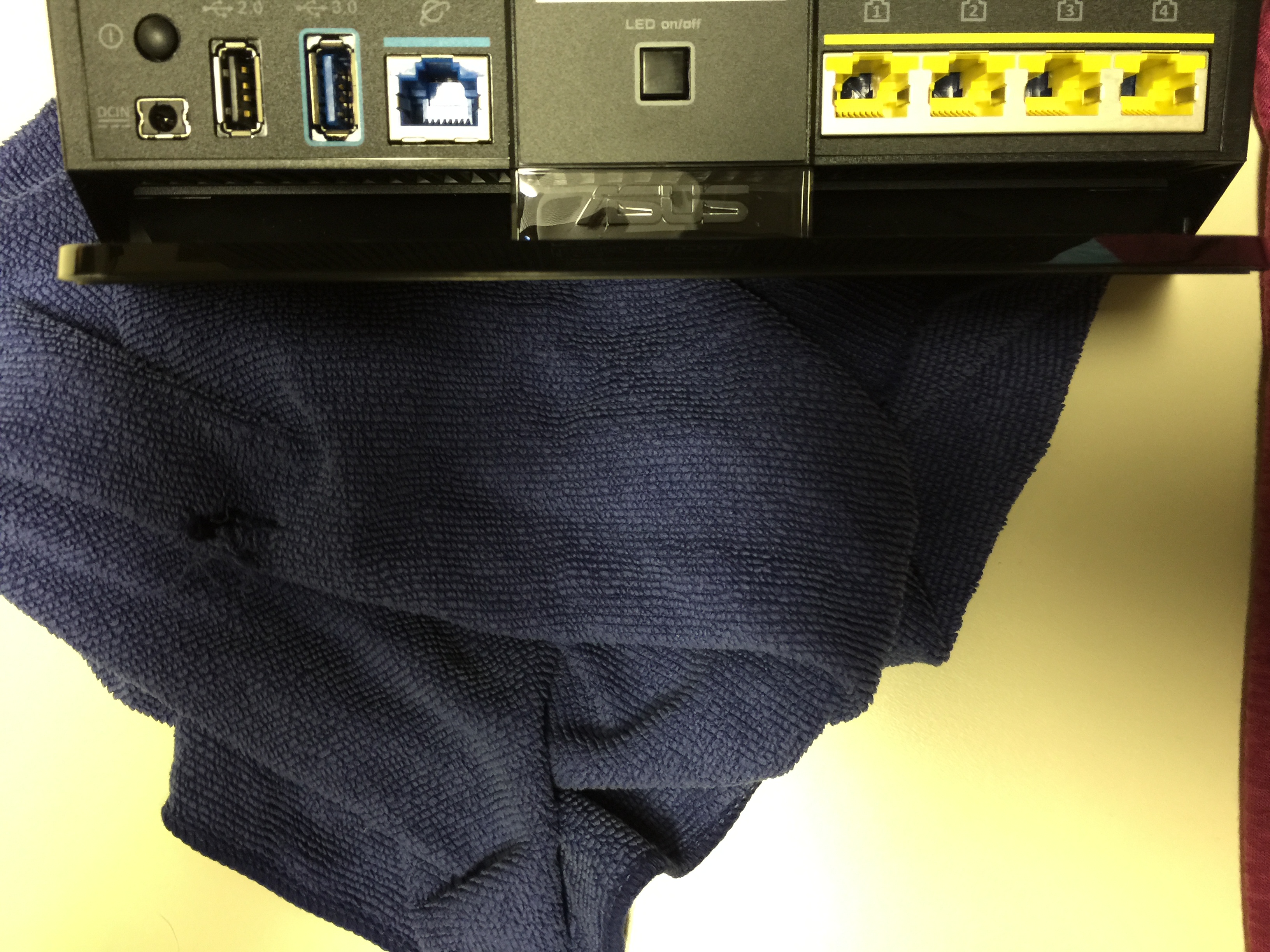

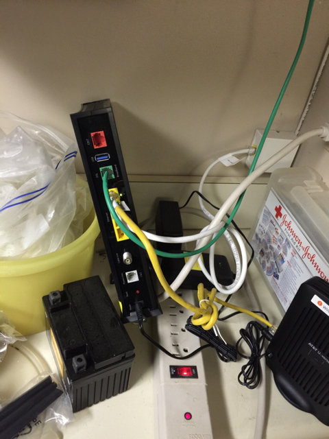

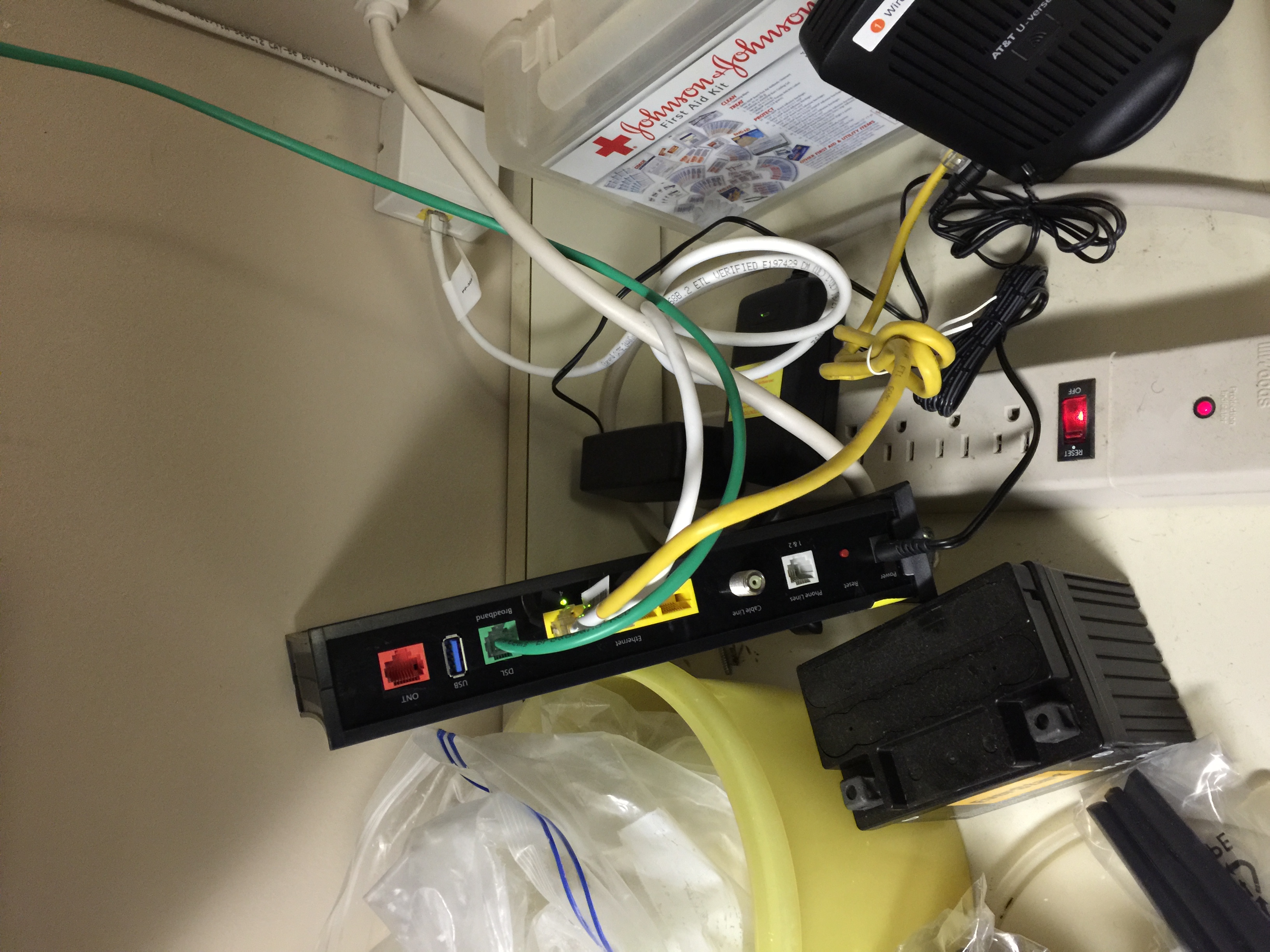

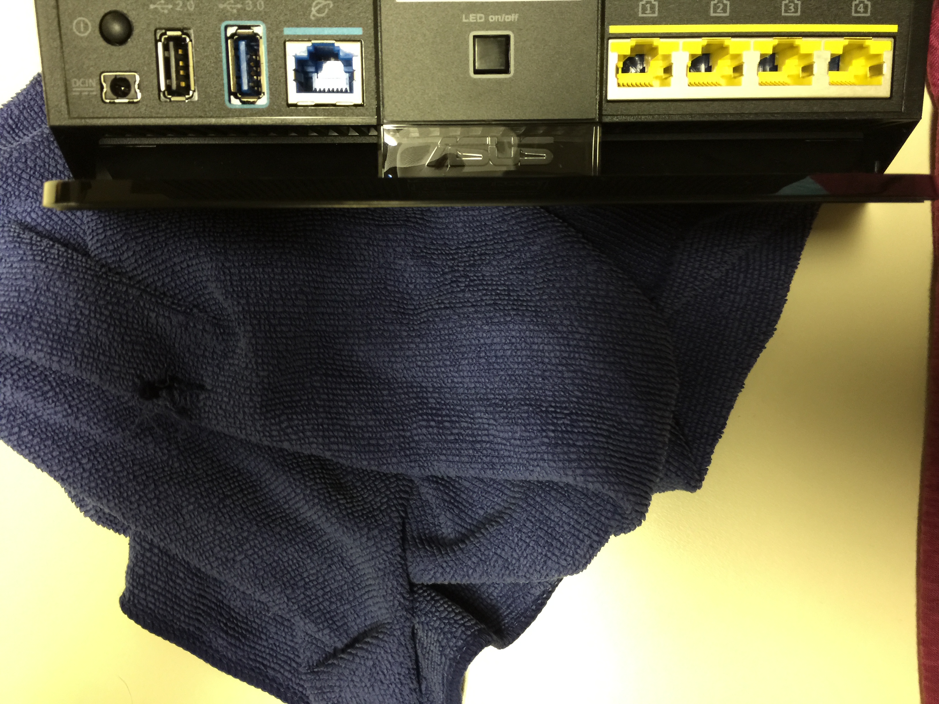

ok..lol heres the back of my att router now the small one beside it is for the television up stairs which it communicates wireless to..the second pic is of the tmobile asus wifi cell spot: I need to know what to plug in and where. The instructions are very confusing for me...where is all the tech/ITT people..lol

I have the same issue, and that's why I haven't even tried to hook mine up yet. I did a lot of searching on line and found a couple of step-by-step posts from other people who had successfully hooked up the CellSpot by piggybacking onto their Uverse modem, but I haven't had the time to try it. Just keep searching online and you'll stumble onto the info. The one thing I do know is that you DON'T replace your Uverse modem with the CellSpot or you'd lose your TV signal.
Slightly off topic, but how old is your Uverse modem? Is it fairly new? It looks real different from mine.
Yes it's new about 3months oldImageUploadedByTapatalk1415971683.218071.jpgImageUploadedByTapatalk1415971700.086187.jpg
You replace your ATT U-Verse router with the T-Mobile router. They're both routers, the one T-Mobile sent you is just made to prioritize their Wi-Fi calling to provide you with a better calling experience when you use it.
I have Uverse, its more than a wifi router, its a router/modem combo. Go in to the uverse router settings and you should be able to disable its wifi from there. Connect the TMo router to it, configure it, and you should be good to go.
First, I think those instructions are probably not the right ones. They first talk about using a modem/router combination (which sounds correct), but they later assume that you have a modem only and that the tMobile device is going to act as the router.
I have never used UVerse before, but on Verizon FiOS, I had to have FiOS set their device into Bridge Mode so that I could install my own router (AirPort Extreme). Setting the UVerse router to bridge mode would allow the tMobile device to act as the router (which is what it wants to do) and apply it's QoS settings for WiFi calling. It looks like your UVerse device is different from what I have for Fios though, and I suspect that if you put it into Bridge mode you are going to lose TV Service.
Call UVerse support and tell them that you want to install your own "Wireless Router" and see if they have instructions for that.
You don't want to have two routers in the same network - one of them must be in Bridge Mode which basically turns off all of the features that make it a router (DHCP, NAT, etc) and renders it a combination ethernet switch and wireless access point.
If you have a fairly high bandwidth - like 15Mbps or better, you probably don't really need QoS anyway and can just send the tMobile device back. QoS just prioritizes certain traffic - so if you were streaming Netflix and a call came in, it would restrict the bandwidth that could be used by Netflix - so that the WiFi Call is guaranteed to have a certain amour of available bandwidth. The thing is, a WiFi Call doesn't really need all that much - these devices were more useful when the best connection we could get was DSL.
I plugged in mine to the back of my all in one port on my router/modem combo. It popped up with the cell spot name and asked for the password for it which that's on the back of the cell spot and then I was connected.
