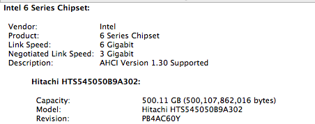

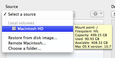

When I open it up, it says Macintosh HD 499.25GB when it should be 500.1GB.. It's missing about 750MB, and the Recovery partition is 650MB.😱 It might copy it over, but judging by that, I don't think it will.
See attached pics.

I don't have experience with lion, but from what I've heard, the recovery partition is supposed to be invisible. If I were doing this my self, I would have followed the exact procedure you described:
