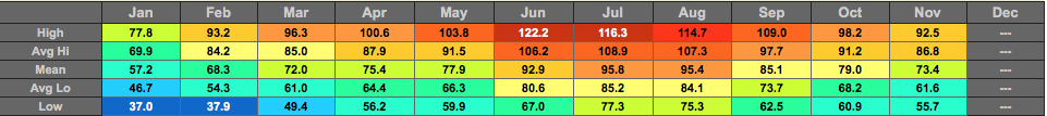

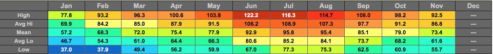

How about with no central cooling ? Where you only use ACs at certain times to save up on electricity bills..... sad stories of a 3rd World/ Developing country 😛
Dang... I feel for you then my friend. I gotta have me some AC!
