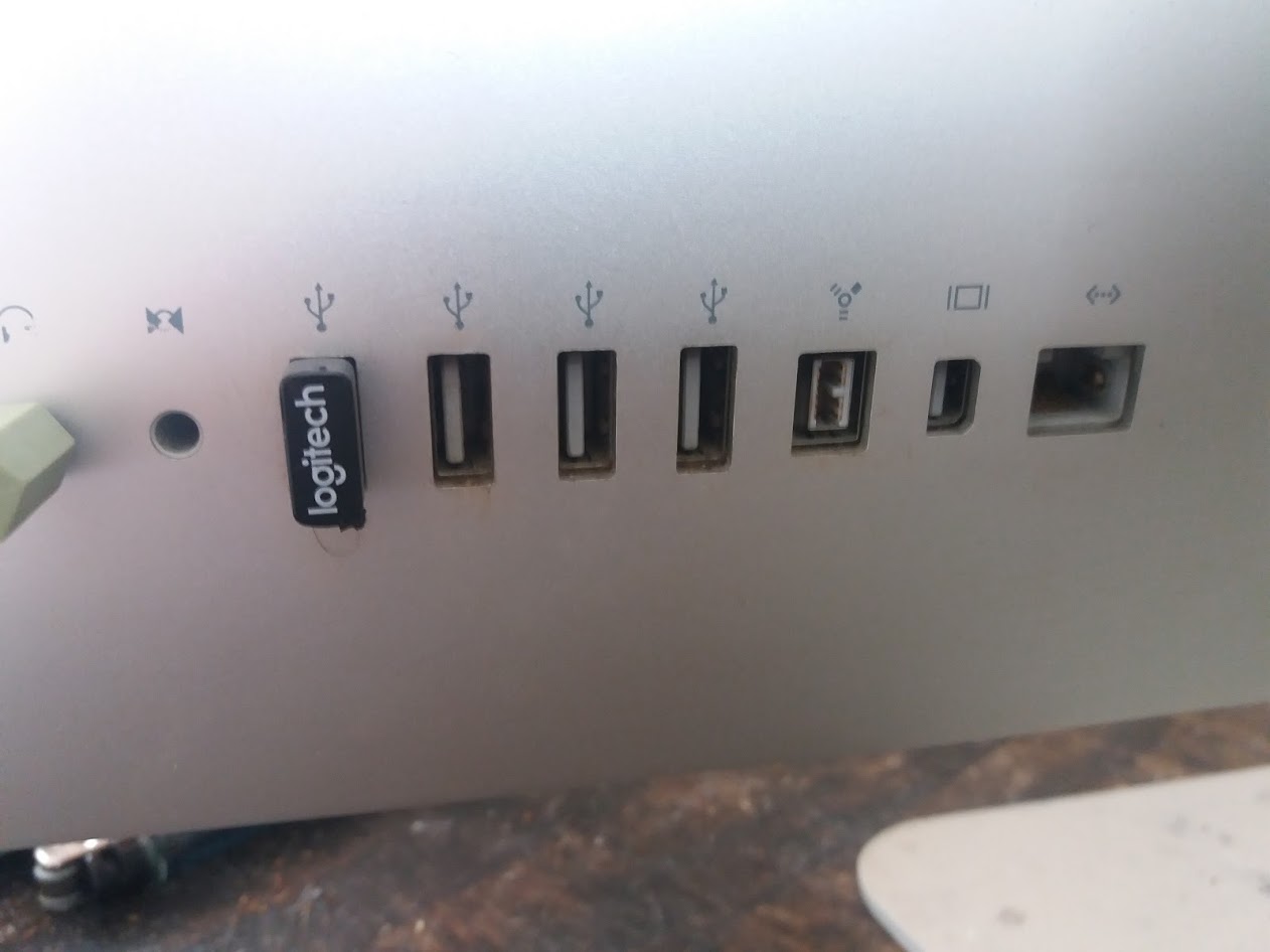

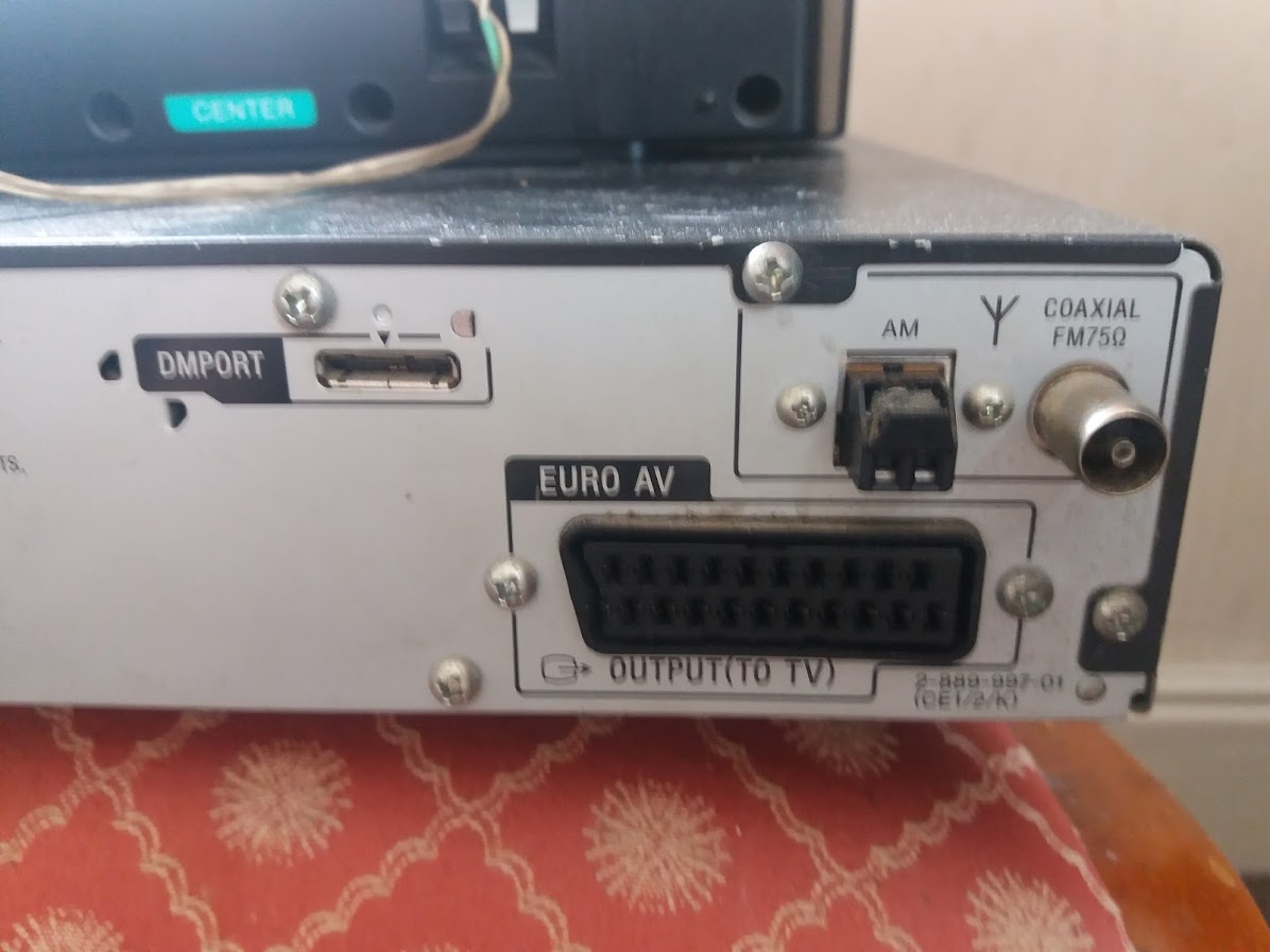

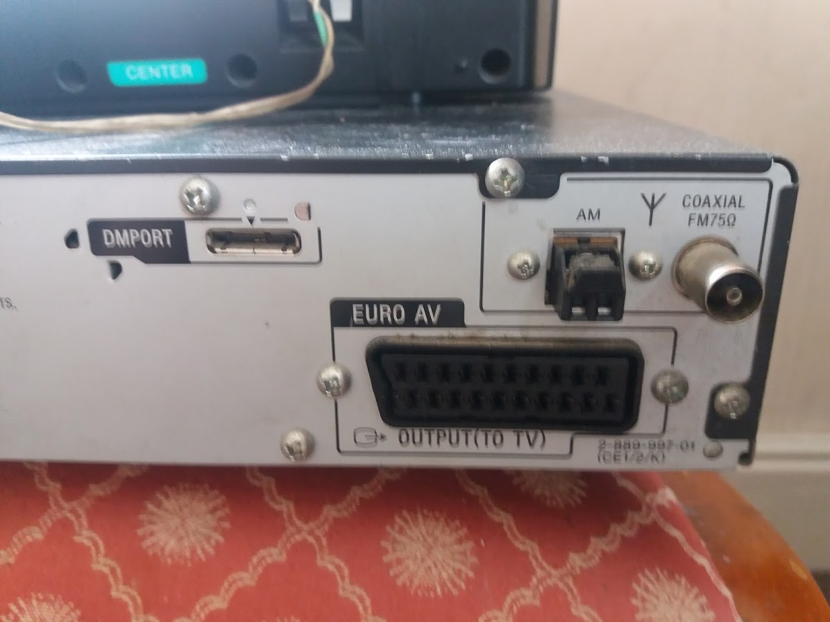

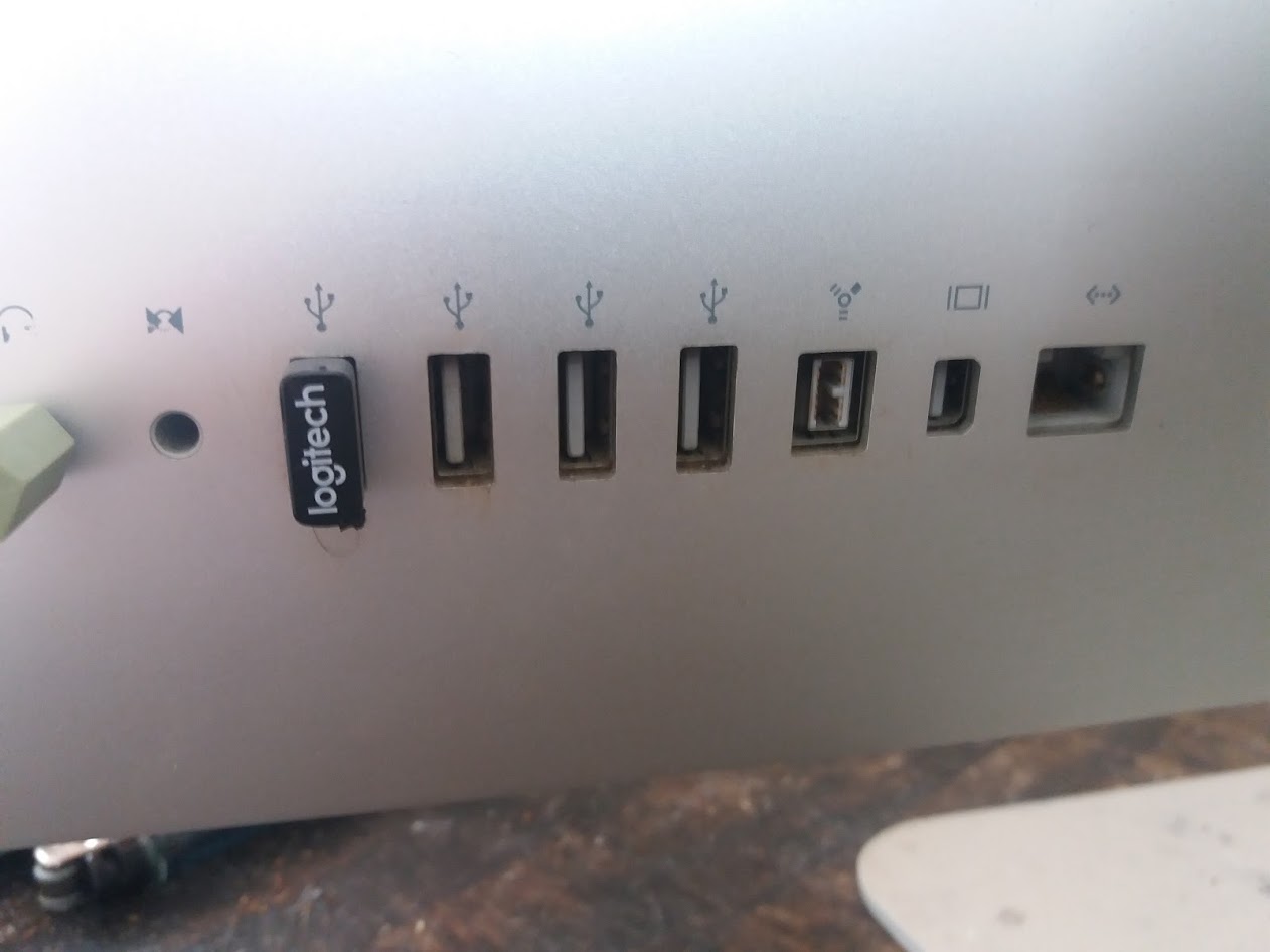

I'm in the UK. I have an iMac (21.5-inch, Mid 2010) that I usually use for listening to streaming internet music by plugging a cheap computer speaker into the headphone/audio-out 3.5mm jack in the rear of my iMAC (pictured attached below). I don't use iTunes and so I'm not looking for high end audio quality if it can't be achieved.
I was given 5.1 SONY-DVD Home theatre system DAV-DZ230 and thought it would be simple to connect but three hours of internet research later, this is the best thread on the subject.
I'm unfamiliar with much of the jargon used here, so I'm going to attach two images. One of the rear output ports on the back of my iMac and the other of input ports of the DAV-DZ230.
Is there a way and/or a cable to connect my iMac to the Home Theatre amplifier?
With these ports, none that I’m aware of ... are you sure it’s the only inputs possible ?
The answer will be a big NO.
Your home theater system does not have any audio input port.

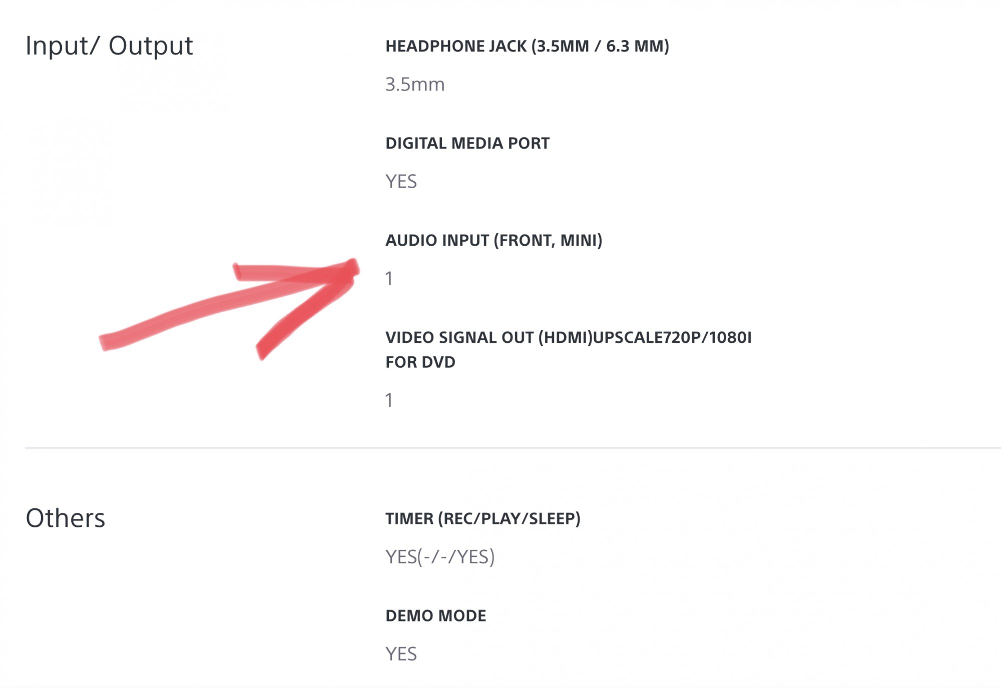

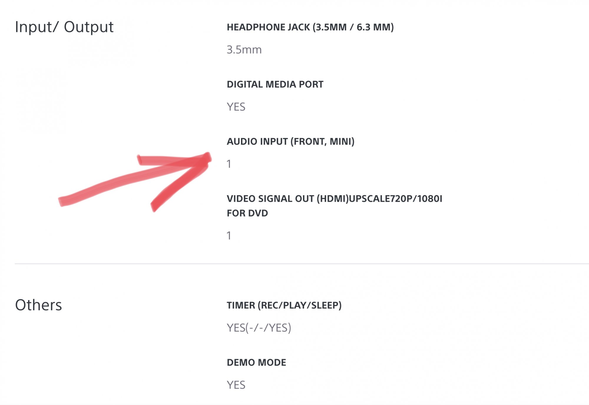

Reading the link to the Sony device, I understand IT HAS another audio-in at the front. If it’s like I presume, you could connect a wire from “audio-out” to “audio-in” at the face of Sony amp.
The DMPORT is some weird Sony thing and I don't think you can even find an adapter.
As J.Gallardo says there's a 3.5mm stereo audio in jack on the front.
