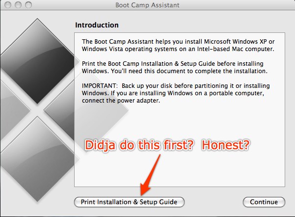

  1. Use the Boot Camp Assistant (you don't "install" Boot Camp) to create the desired Windows partition.
  2. Install Windows per the instructions, so we don't get the wrong answer to the question in the image below.
