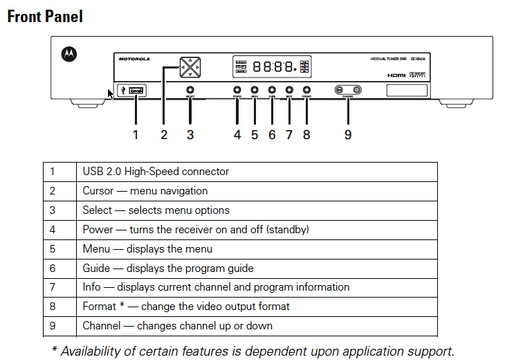

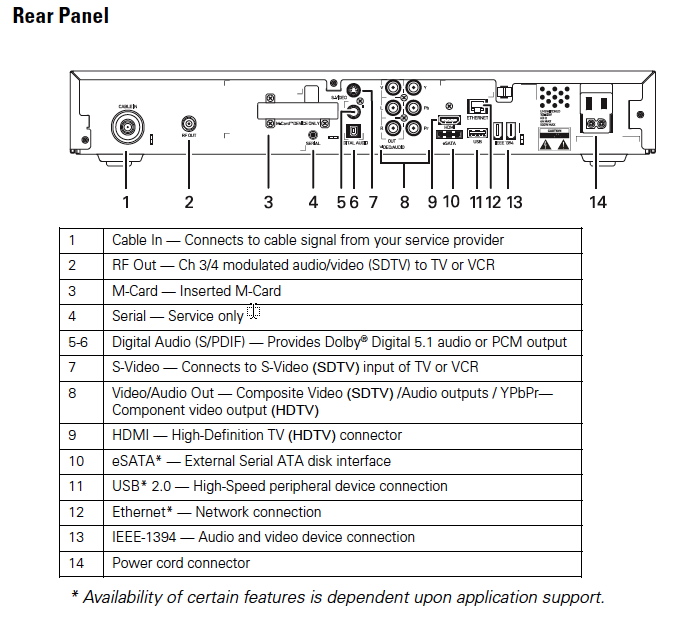

Ok so I have the brand new Motorola DCH3416 DVR Box. It does not have a fire wire hook up. I have attached photo of the front and rear panels of the box to show what it does have.
I am using a 13" Macbook and would like to be able to hook it up to this box so that I can record onto the macbook. If anyone knows how I can do this than please help. Thanks.
Actually, if those are pictures of your device, it does have Firewire -- Firewire is also called IEEE 1394 (it's pictured on the right-hand diagram, on the lower right side of the device back).
But honestly, I have no idea if it will let you copy shows off via firewire (or anything else), off hand....
I have a similar DVR box that came from my cable company. Though it has the firewire port, it is not turned on and as such is useless. If it happens to be turned on, Apple provides a Firewire SDK download that supposedly can let you record from firewire, but since my box was disabled I never got very far along. I was working from a tutorial I found through Google.
Edit: just found a very similar tutorial as the one I was using.
You should also look into Elgato's EyeTV.
