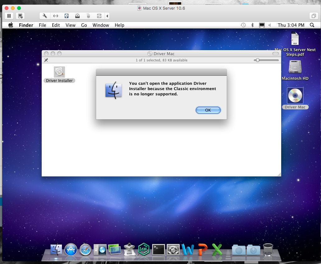

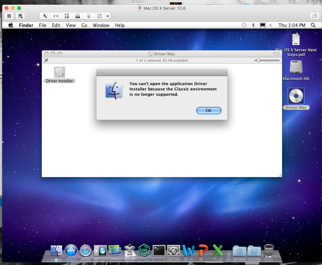

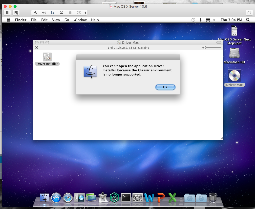

Here's your answer on Snow Leopard...
I'm a bit confused, why does it say that the Classic Environment isn't supported?
The short answer to this is that it's an OS 9(or earlier) native app.
Up through OS X 10.4 on PowerPC, you had something called "classic mode" which would run an OS 9 Virtual Machine inside OS X. With classic mode, a G5 Quad made in 2006 could run Macintosh software released in 1984.
With the release of the first Intel Macs, classic mode went away. Rosetta can emulate a PowerPC processor, but only in OS X.
What this means is that you need to either a. get Sheepsaver running(which may be less than satisfactory for a GPU intensive game) or b. Set up a Mac running OS 9.

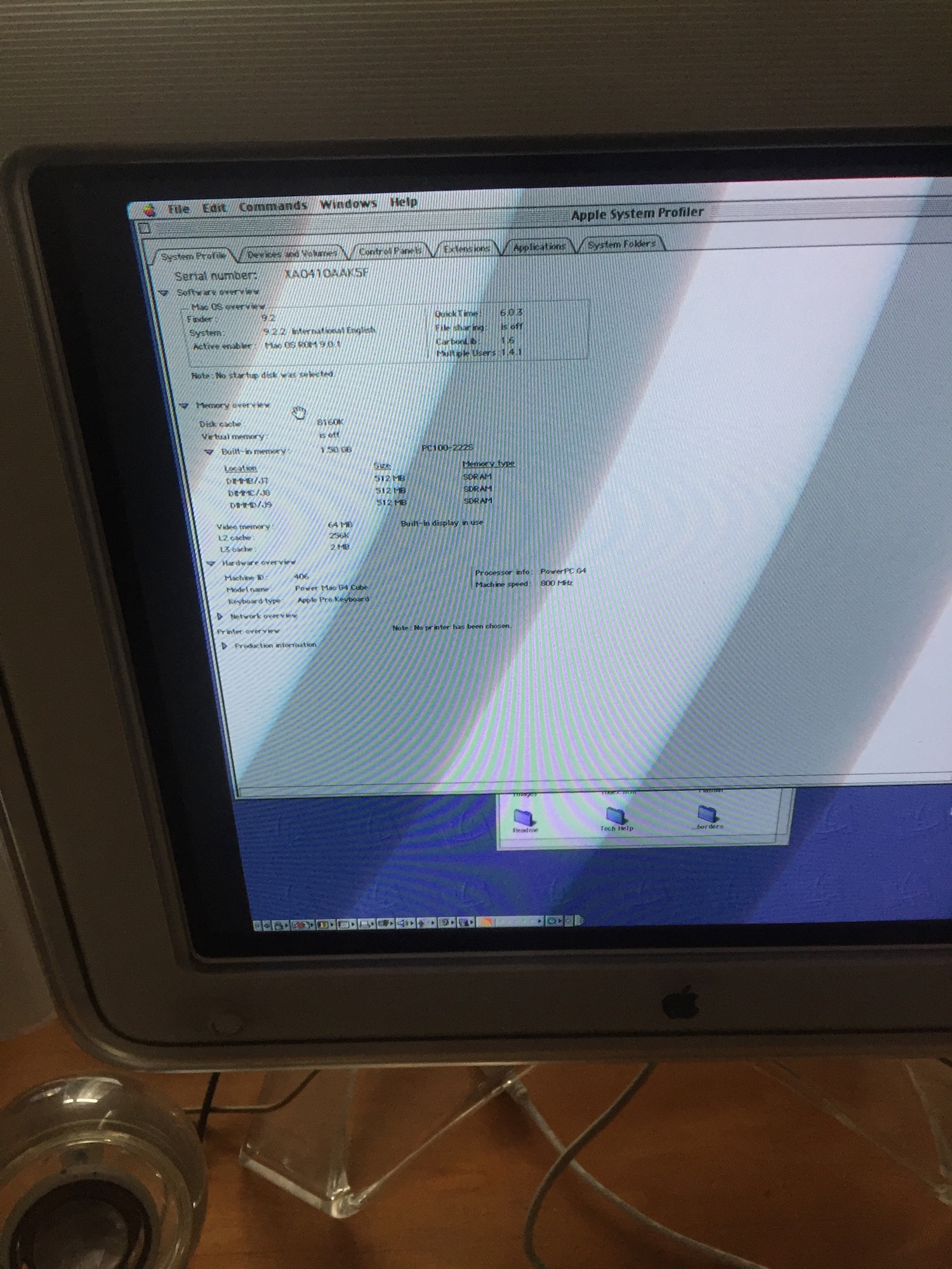

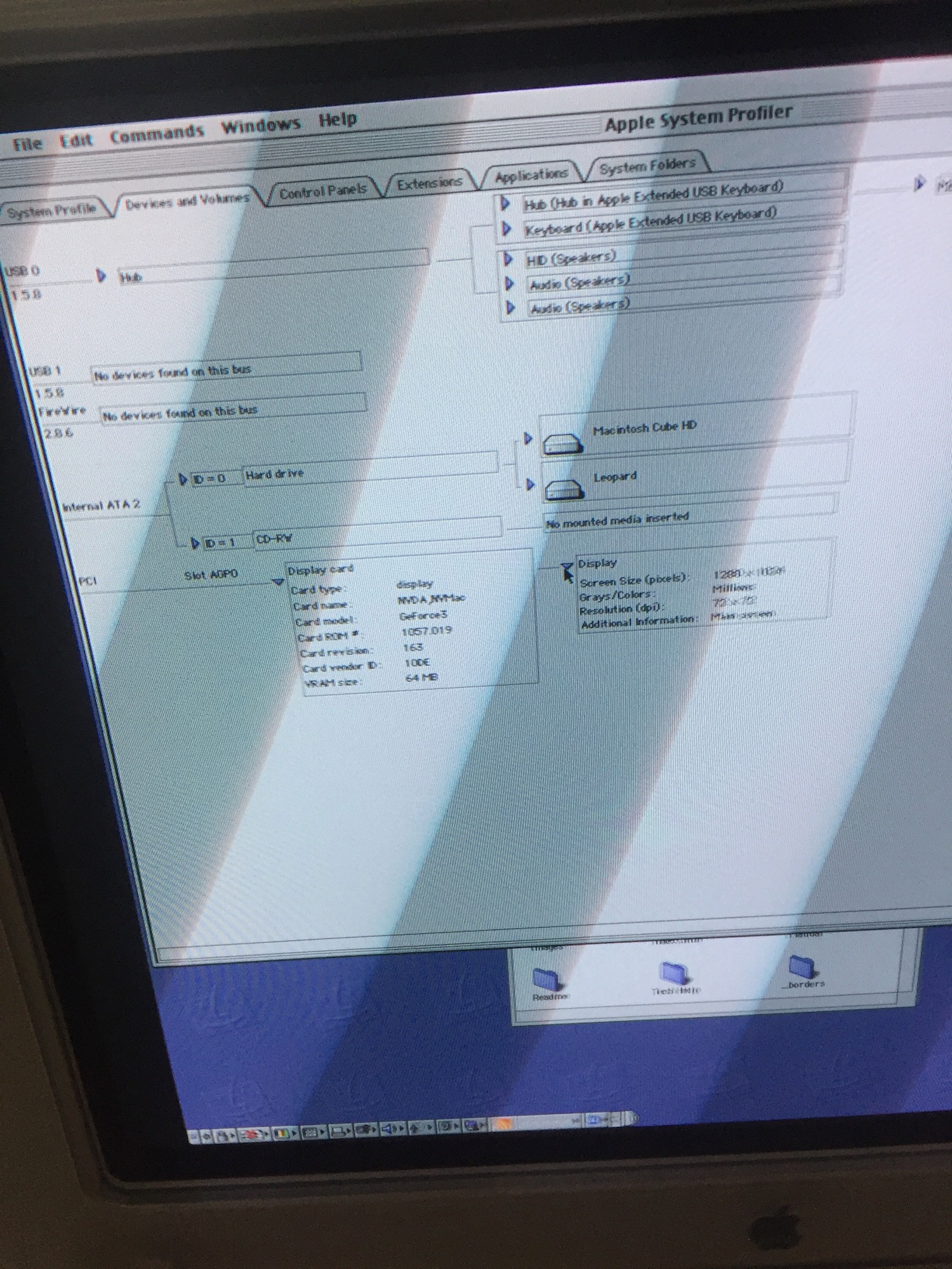

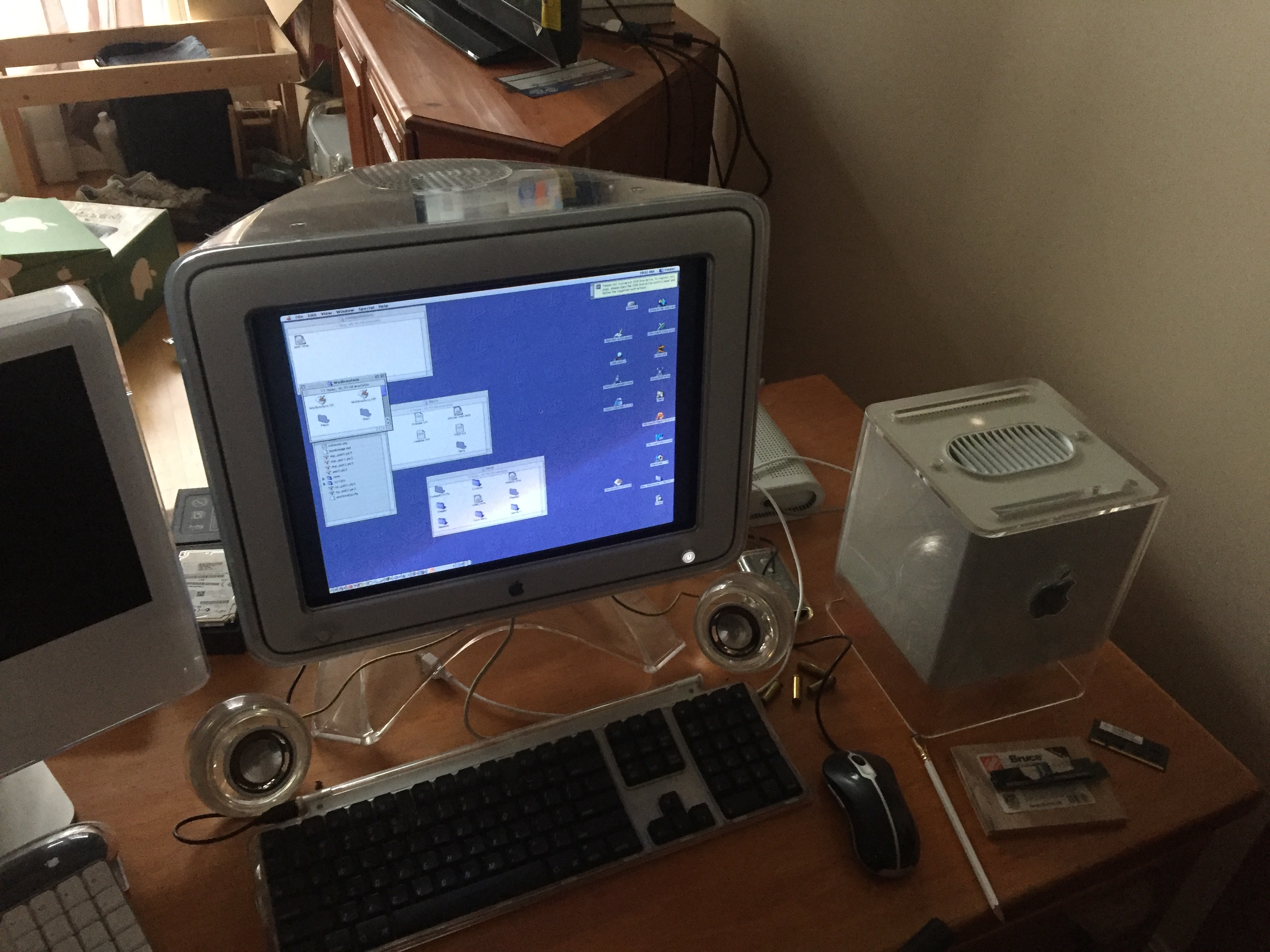

Not to hijack the thread, but I had a recently "retired" Quicksilver(or at least retired from daily service) and decided that I couldn't stand to leave it idle 🙂 .
I had tricked the computer out for OS X which limits its OS 9 utility, so I opted to revert it to a high end OS 9 configuration. It is a factory dual 1ghz. I put in a Geforce 4Ti(to replace the Radeon 9600 I was using) and reinstalled the Airport card.
In any case, I've been playing the specified game on that computer. I'm using a Logitech USB game pad, and everything runs great.
I'm just going to make another endorsement for running it on a dedicated OS 9 computer. For a c.1999 game the 4Ti really is overkill, but you can never have too much GPU.
