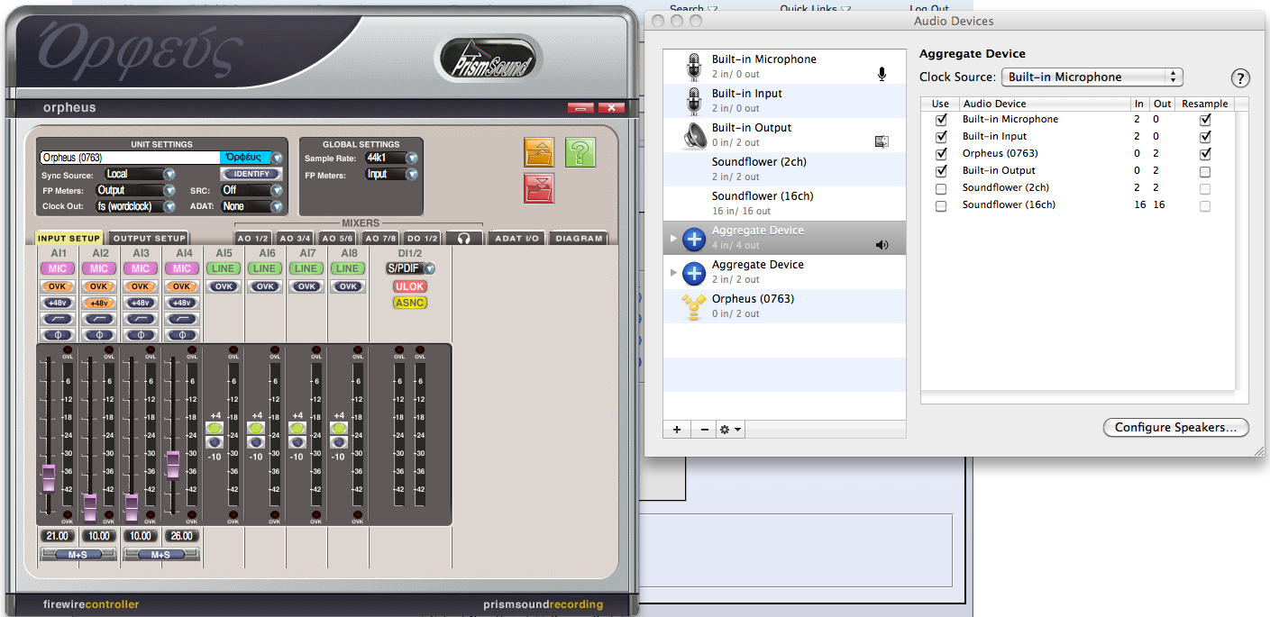

Here's what the audio midi setup panel looks like with the external soundcard switched off (i.e. not plugged in at the wall)
And here it is once the soundcard is switched on.
Note: I used Soundflower once, many months ago, but have since been told that it's no longer necessary because of "aggregate devices". I don't really understand aggregate devices, though...

An aggregate device allows you to combine different physical input devices into a virtual device that may be selected in programs like Logic and Garageband. In the past I have created an aggregate device for using a USB microphone along with a two channel USB audio interface. With this setup, for example, my audio interface might appear as inputs 1 and 2 in Logic and the USB mic appear as inputs 3 and 4.
Logic can be a little buggy with this sometimes and won't recognize the aggregate device. The solution was deleting the device and creating a new one. I have also seen the problem with distorted audio from Logic, but quitting and restarting Logic always cured it. I no longer use an aggregate device in Logic and have not seen this problem since then, so I suspect it's related. The ability to combine things into an aggregate devices is dependent on driver software. I now have an EIE Pro 4 channel interface and it does not support aggregate devices so I can't use my USB mic with it.
