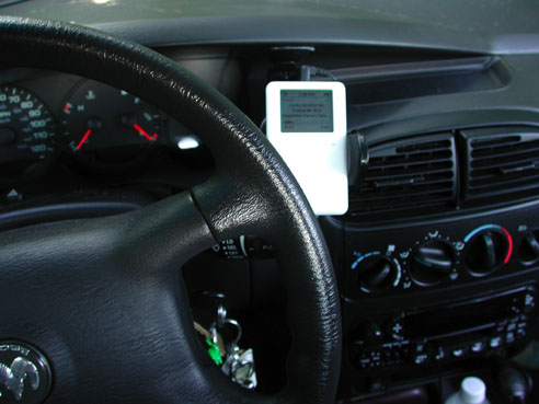

I got a neon
I went to a closeout store and pick up one of those cell phone holders kits for $5.00 it fits my 15Gig iPod perfectly and a cassette adapter, put it next to the signal light switch just close to my fingers (sweet). I see the display and use it turn the volume up and down from the ipod it works fine. but I would like to get the rca adapter but for my car is $100.00 and it's not worth for now.:D

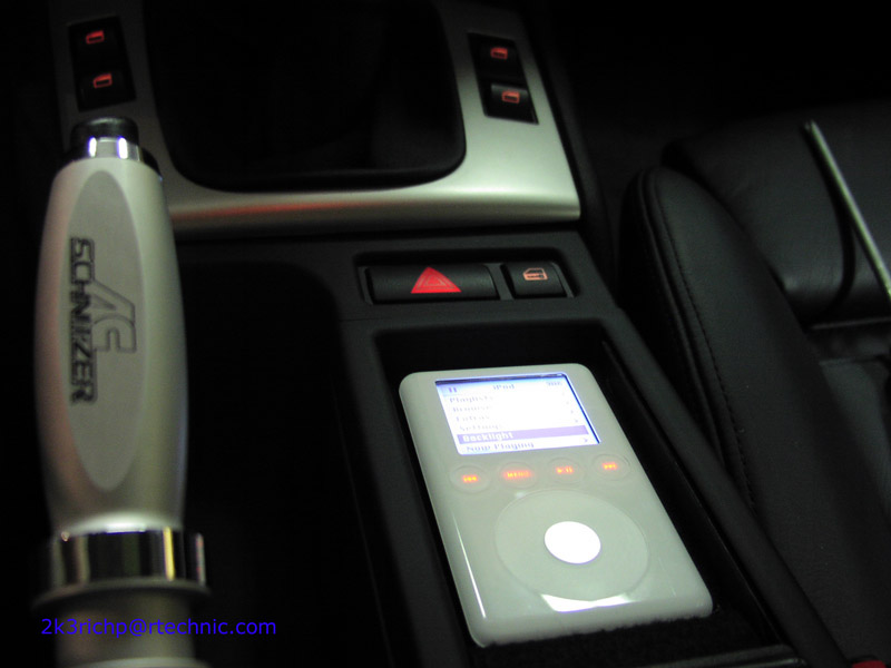

Here is my setup in my BMW; I ordered a european sliding tray, then built a base inside (felt lined) to hold the ipod. I purchased a belkin cig light charger/audio out and hacked it up for hardwiring. It feeds the stereo using a derived source on the OEM navigation; however, I will note I had to use a line driver (read: signal amplifier) to get the signal strong as the CD changer and radio. It works great, and sounds terrific (no surprise) One of my favorite things in the car.

thank you both, its a 330ci, with an ac schnitzer body kit and a bunch of other junk..hehe
personally, i like how the orange buttons match the interior lighting :D
