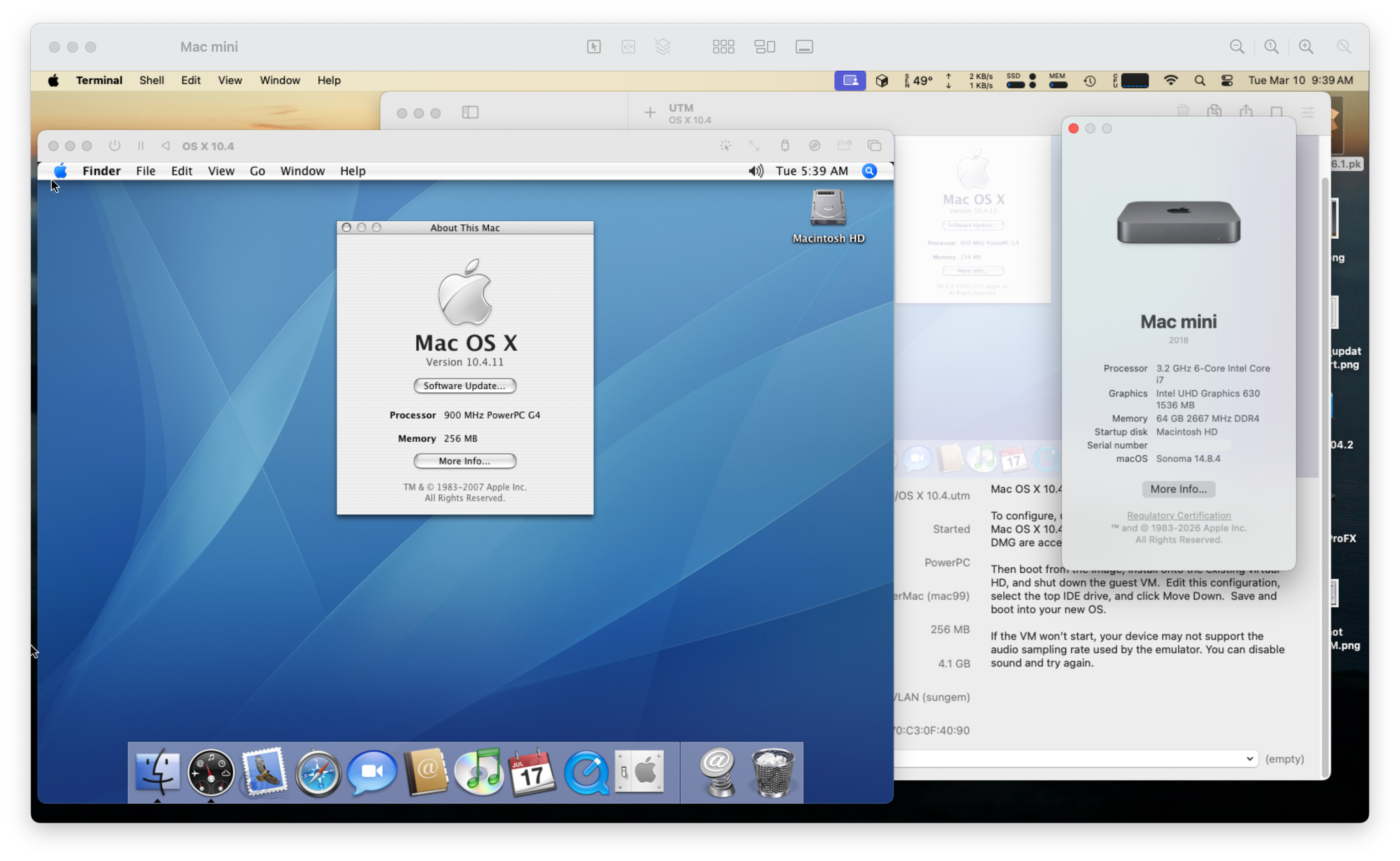

Tiger running in UTM on Sonoma on a 2018 Mac mini viewed through Screen Sharing on M1 Max MBP running Sequoia.

I might ask you a few "help me understand the basics" of using UTM on Intel in the next day, because it's almost impossible to find instructions for running it on Intel that are as clear as the instructions for using VMWare to do Intel-on-Intel.
