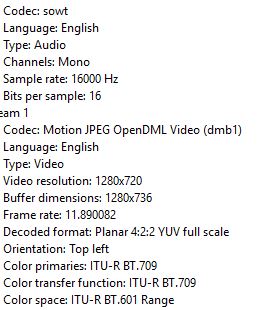

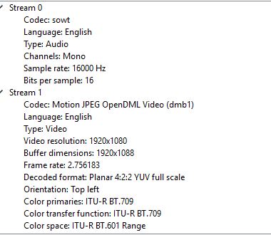

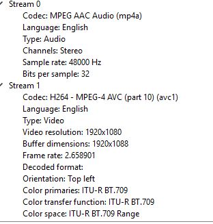

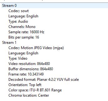

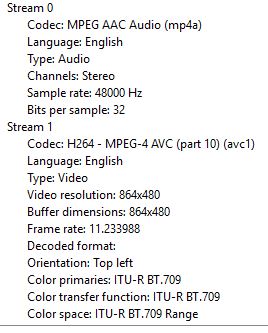

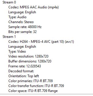

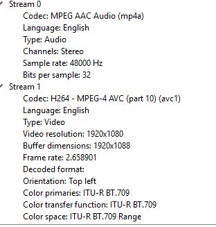

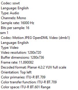

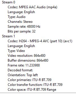

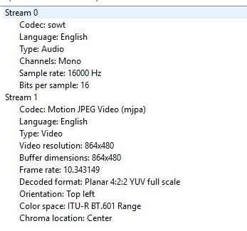

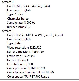

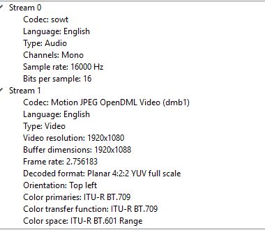

Poor results with the 17" GHz Powerbook 2 Gigs of RAM and SSD on Leopard.
Logitech software offers RAW for importing on iMovie or Compressed files (H264) options . The files get compressed after the recording. Here are the tests for 480, 720p and 1080p.
480 Compr.JPG 480 RAW.JPG 720 Compr.JPG 720 RAW.JPG 1080 Compr.JPG 1080 RAW.JPG
Reactions: B S Magnet
While the drop with 1080p isn't unexpected, it is interesting to observe how the performance for 720p generally exceeds that of 480p. Any idea why?
