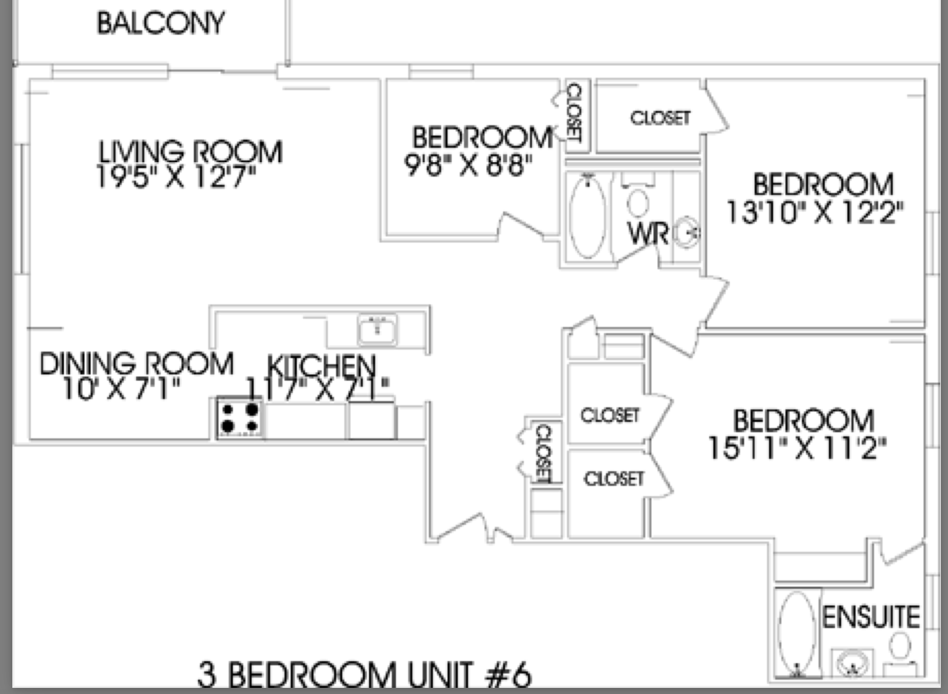

The pic below is the layout of my apartment. It's an older building which was built in the 1970s so more solid walls throughout (perhaps concrete?). The modem from my ISP and the AE are in the living room on the wall between that room and the small bedroom. I'm mainly in the middle sized bedroom (top right corner) which I use for my "man cave". I don't do any heavy video or photo editing. Mainly web browsing, email, watching YouTube, Apple TV, AirPlay for music.

Due to the layout, the Wi-Fi signal must penetrate multiple concrete walls.
I would suggest purchasing a mesh Wi-Fi system and placing one of the units near your room. This will help us overcome the physical limitation.

I guarantee you there are no concrete walls in your apartment (other than possibly the outside walls, and even then, they're probably brick - which is very different than concrete in the context of what we're talking about).
With an apartment that small you shouldn't even need a two-piece mesh setup, though it would probably provide the best results. You probably just need (any) new router.
