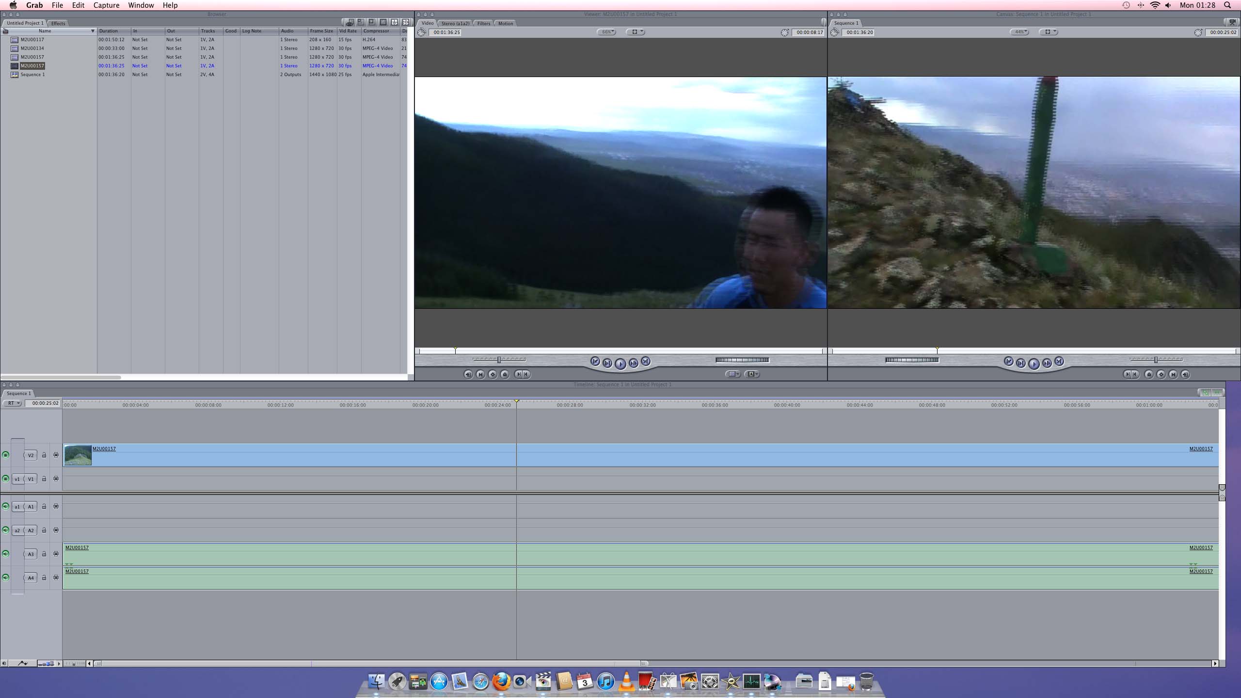

I am having the same problem with my Final Cut Exprs. To explain it, I have attached a screenshot of the jagged edge.
Thanks
This is not what is normally meant by "jagged edge." Your source files have interlaced video. I assume that you want progressive video. The free utility MPEG Streamclip will convert your source from interlaced to progressive among many other things.
