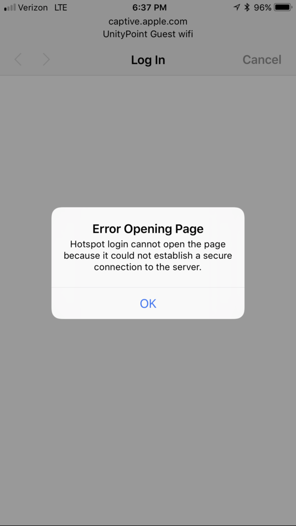

My work wifi (a hospital) always has a page popup when you connect to wifi to"accept terms and conditions" to join the wifi network.
Since beta 2, it no longer pops up for me. It just says its connected to wifi, but it doesn't load anything or do anything.
My friends at work, their iphone 7(ios10) and google pixel get that popup to join
