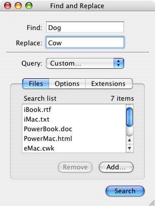

I'll soon be releasing my first Mac OS X native application, MassReplaceIt. Basically it does a find and replace on either the contents or filenames of a list of files you give it, so that you don't have to open them individually (screenshot below). It will be released as freeware.
I developed the application in Panther, however it should also work in Jaguar, although I'm not entirely sure since I don't have access to a machine with Jaguar installed.
I'm interested in people's feedback on it. In particular, possible interface improvements and bug reports. If anyone tests it in Jaguar, I'd be interested to know if there are any problems with that. Help is available from the Help menu if required.
The beta version is available here (120 KB).
Thanks for you help. :)

I've finished a new beta. Changes are:
  • Renamed "Search" button to "Replace" to better reflect its purpose.
  • Now allows blank search text when searching at the beginning or end of a file/filename (provided the replace text isn't blank), to allow you to insert text in the corresponding place.
  • Added help page for above ("Inserting and deleting text")
  • Minor changes to the error message shown when the search text is blank.
Again, feedback is appreciated.

The application seems very mature. The interface worked better than I expected. I was able to drag files to the search list, good, I could double click files to open them from the result sheet after a replace, good.
It seems to do what it promises also, but in my opinion, the default setting is a little dangerous. I would like the confirm changes option on by default. It would be very nice to see the lines that would be affected in the confirm dialog, although I realize that is a lot of work to implement. It would be even nicer to have checkboxes next to the lines for individual confirmation. Also, in my case, since I tested it on code, the default option of case-insensitivity caused me unexpected results. I didn't find an undo option either. For code I wouldn't really use this app, though, since Xcode has its own project search and replace, so maybe others prefer the case-insensitivity by default.
Overall a very good app, but maybe a little dangerous for uneducated users.

Thanks for the compliments everyone! The application will probably be released within the next few days.
That's a good idea, it will be on by default in the next beta.
An interesting idea, although it would be difficult to implement. I am planning on improving the whole confirmation process in a future version, one major improvement being that the files with changes will be added to a table as they are searched, where you can open them and confirm/cancel changes either individually or for all files, while the application continues searching the other files.
I think I'll leave the default as it is for now, but thanks for letting me know. As for undo, I don't think I'll ever add that, as I'd probably have to store copies of all the files' original contents in memory.

I've just finished MassReplaceIt 1.0b4. Changes include:
  • Changed default options. Case sensitive and confirm file changes are both now on by default, and search filenames is now the default instead of search contents.
  • Added confirmation before search begins that can be turned off via a checkbox on the confirmation or in the preferences.
  • Replace button is no longer the default to prevent accidentally starting a search by hitting the return key.
  • Fixed major bug that preventing adding a query if none had been added before.
The new beta is available here.
