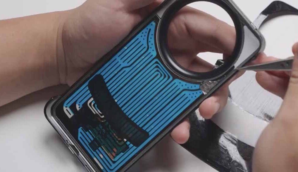

Huawei sells a case for the Mate 60 with a micro pump and liquid cooler powered by reverse charging. Maybe Apple will do the same? 😀 And copy the satellite voice calling and SMS feature while they’re at it.
