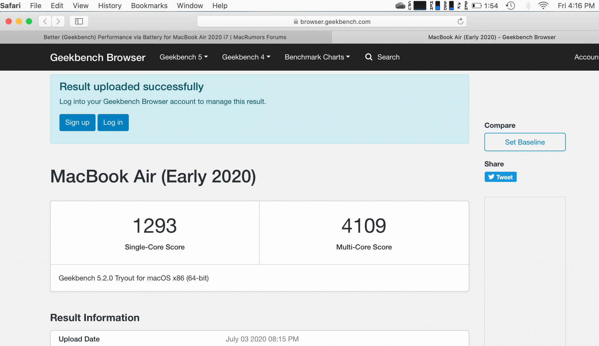

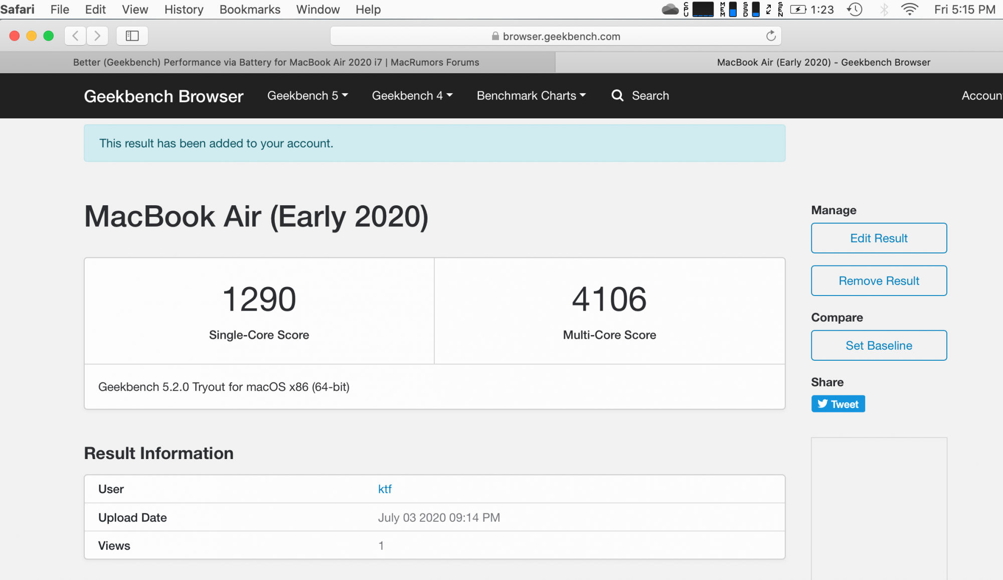

When on battery and I am not sure at what point but lower battery it seems not to be checking stuff in the background like Photo, Calendar, Accounts, System Update, Windowserver, etc. Seeing I was 98% CPU usage on battery I just ran the GB test while on battery and only 2 hours left of charge 1293SC 4109MC. Then I plugged it in and all of a sudden I am down to less than 65% CPU because I am on power and its checking everything in the background. If I ran the test now it would be total crap like you posted.
Now I wait till its done checking all the background stuff and I am on power with 98% CPU. I run the test and get about the same results. You can see from my 2 screen shots one is on battery and one is on power.
so Generally speaking you are incorrect, and if you are running 10c warmer with power vs battery and can’t determine why, call Apple. I run the same temps either way.

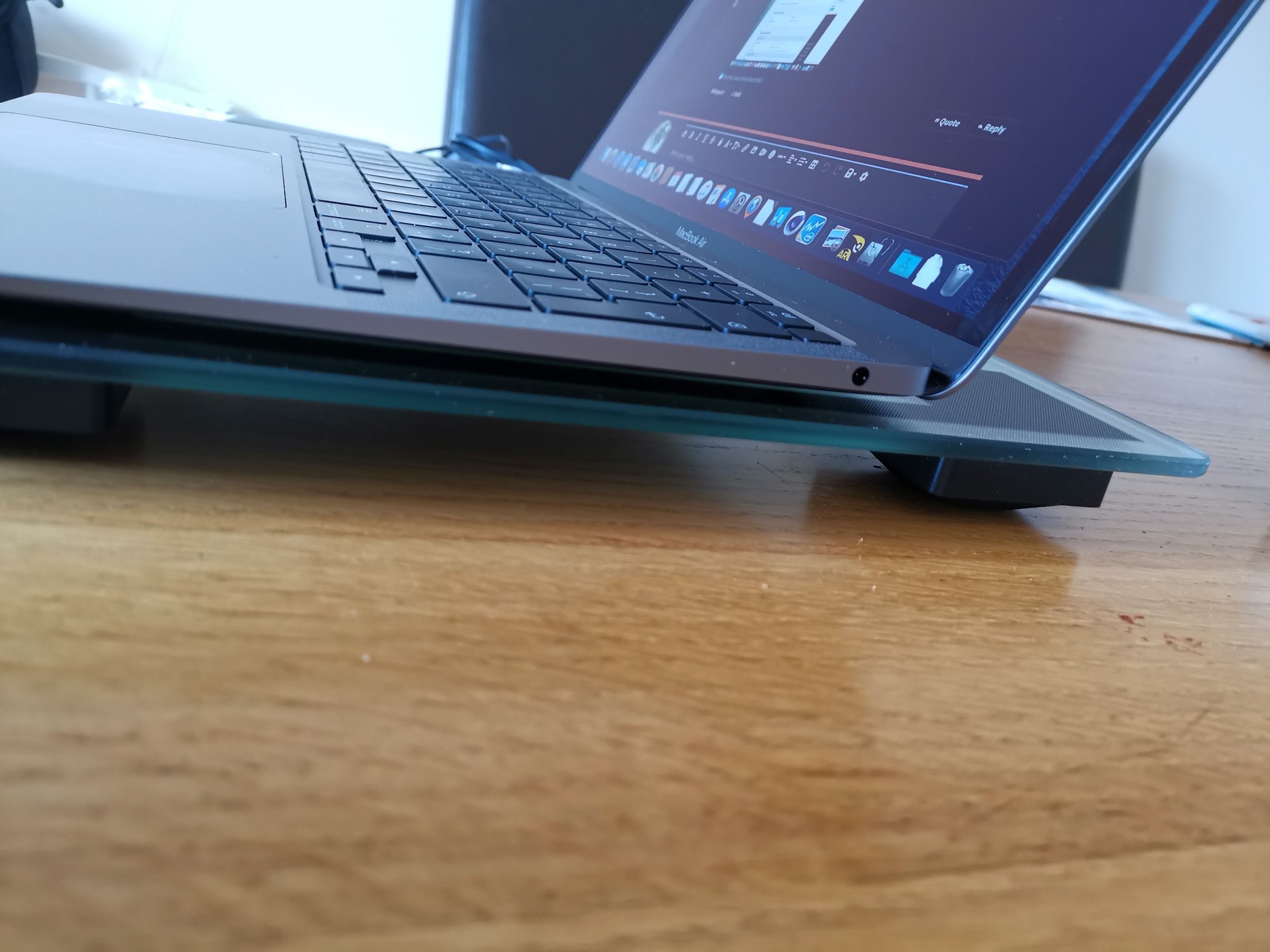

Yesterday I was having a bit of a clear out and found some bathroom scales, the ones with the clear tempered glass platform and a LCD display with the mounting feet containing the strain gauges.
After removing the display it is the perfect size for a laptop stand and the glass is a better conductor of heat than the wooden desk that the Air usually sits on.

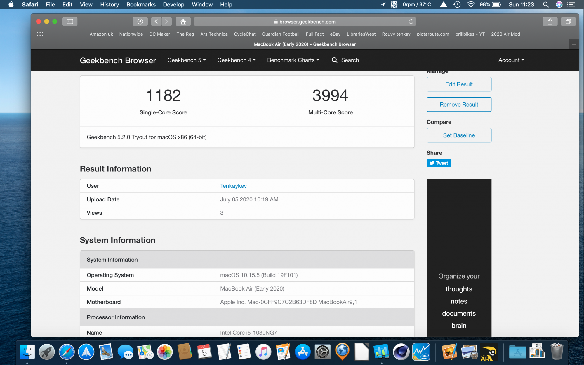

Switched the Air on this morning and went to make coffee. Came back and fired up GB5 with the results 1166/3986
I've been repeating the runs from time to time this morning, letting the temperature settle back down to a typical 35-45C.
I've had 5 runs all in the 3900's with a high of 1182/3994
That's quite respectable for an i5, and best of all is the complete lack of fan noise.
View attachment 930859IMG_20200706_150112.jpgScreenshot 2020-07-05 at 11.23.28.png

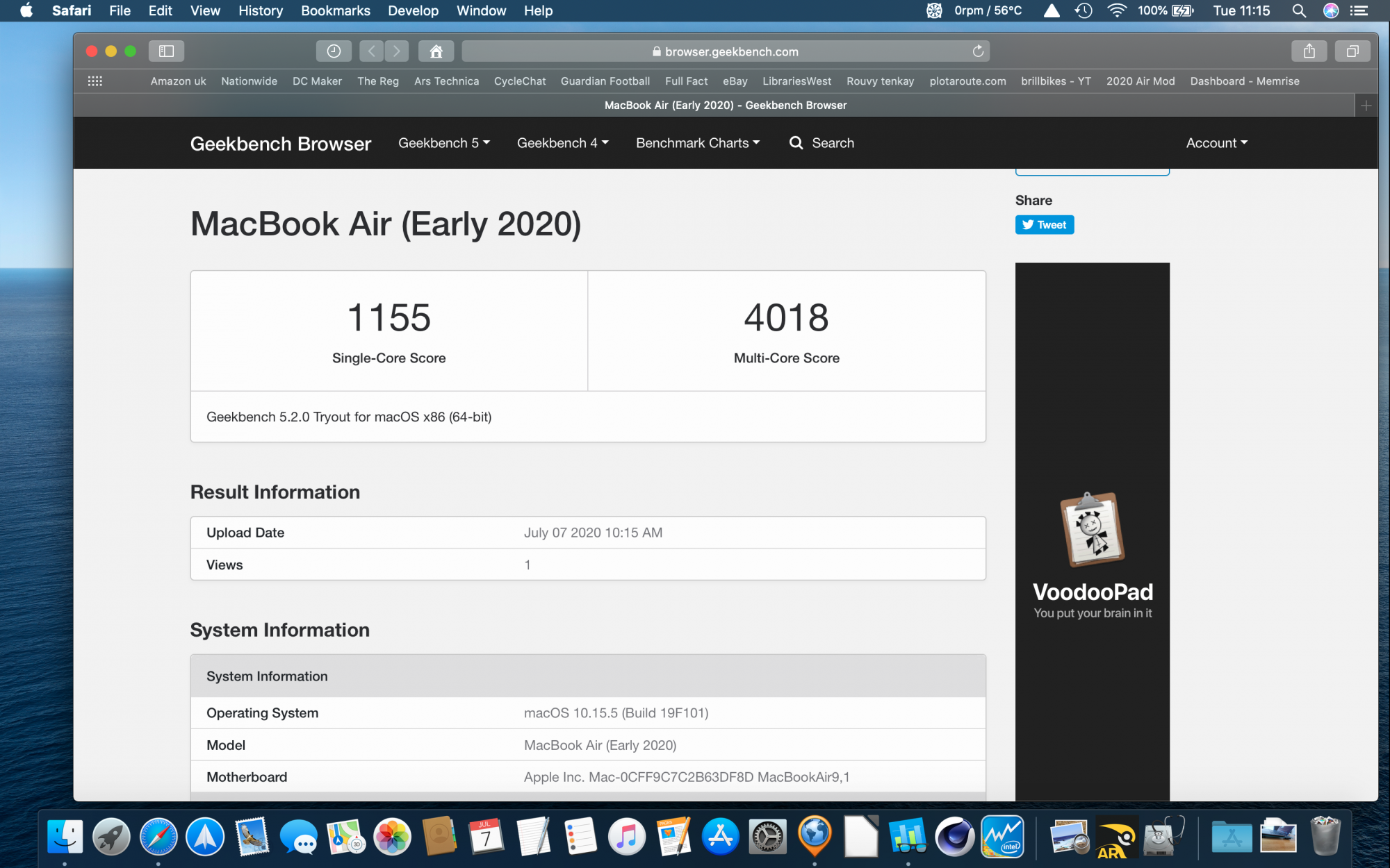

Having previously done the copper shim upgrade, this morning I fitted a thermal pad to the heatsink, sized to fit between the inner of the screw holes on the heatsink.
Now getting GB5 scores of 4K. Base isn't getting hot and running Cinebench the processor never reaches 100C.
GB5:
