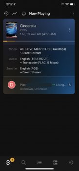

Infuse has a simpler interface and is good at handling homogenous libraries.

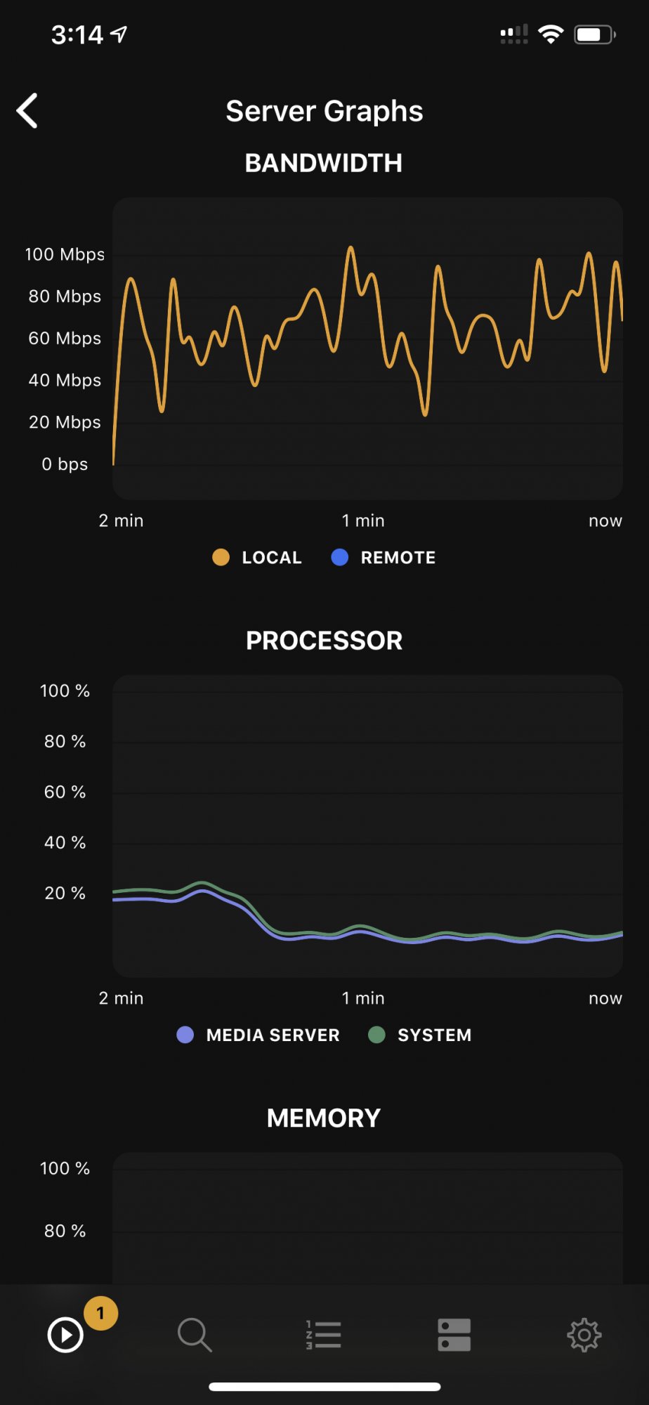

Plexs' interface is more complex. It has a ton of options for sorting, viewing and data collection. There are a number of auxiliary applications such tautulli and IOS plex dash, with data analysis options not provided by the Plex dashboard. CPU & Memory use, active streams and their transcoding status (transcoded, direct play), most watched, recently watched, etc. Plex is the app to use if you are a data junkie.
Plex requires a Plex server running on your media source. Infuse can use either a Plex server or an SMB server. SMB sharing is supported on Macs so you can use infuse without having to run a server so it is the minimalist choice.
I have thousand of videos - including 4K movies, Blu-Rays, DVDs, YouTube Videos, Travel Videos, etc. Plex makes it very easy to find the last youtube video I added, and then seconds later sort by rating. It is very easy to change sort and search criteria on the fly. Harder to do in Infuse.
I have attached a couple of the Plex Dash screens. You can be watching a movie on your Apple TV and use your iPhone to monitor the server:
