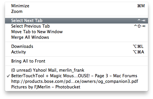

Here is the Safari keyboard short...
Not sure what it is... I thought ^ was the control key, but when I try that shortcut it doesnt switch tabs. Anyone get this to work?

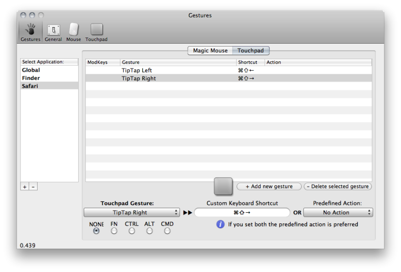

Im trying to set this up also and cant get it to work. Anyone get Safari or even Firefox tab switching to work?
EDIT: Got it to work. Here is my preference pane...
Now I just tipTap and it changes tabs. I cant seem to find the shortcut for Firefox though.
How did you get it set up brah?
Select the gesture in the left hand drop down, the click into the keyboard shortcut field and perform the actual keyboard shortcut. It will automatically populate the shortcut into the field. Make sense?
Yeah I did try it... I tried the command+shift+ left and it wouldn't work
Hmmm, not sure what the deal is there Max, sorry man. Mine works pretty well. Post up a pic of your pref pane.

I didn't restart BTT
/facepalm.jpg
it works perfectly now.
