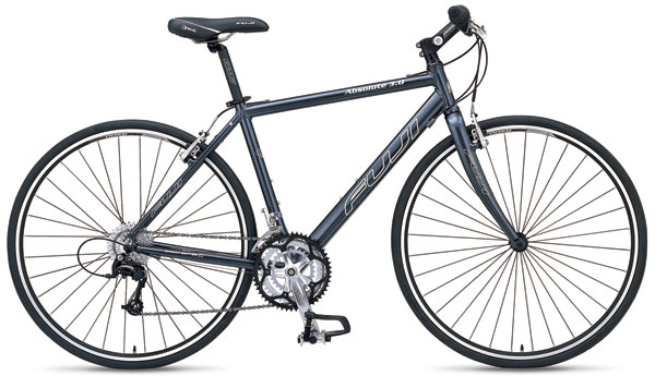

i have the fuji absolute 3.0 road bike with straight bar handlebars. I want to get drop bars on it. how much will it cost to do it?
and no, i do not want to buy a new bike. I just got this bike, and it serves me well.

I went through the very thing as I was trying to see if the Specialized Sirrus could be made dual-duty. You need new brifters (brake lever + shifter - In your case look up Shimano Tiagra ST-4400 for a 9 x 3 shifter), new stem, new bars. I'm under the impression that the mini-V's need the same cable pull as road callipers so the Tiagra levers should work, but you'll need to check with a bike shop. If this isn't suitable, you'll need to buy a pair of calliper brakes as well. The brifters are $200 to start. Add bar + tape+ aheadset road stem of choice.

the only problem that i have encountered when changing handle bars is that the brake/shifter cables are to short. if this is the case, (most likely) you will have to re-do all the cables. it can be pretty expensive at a big bike shop, if i were you i would look to a small bike shop, that gets it's advertising word of mouth, that way you know it is good, because people wouldn't be talking about it.
But if you are up to getting new cables and installing them, drop me a pm. i do work as a bicycle repairman (apprentice).
