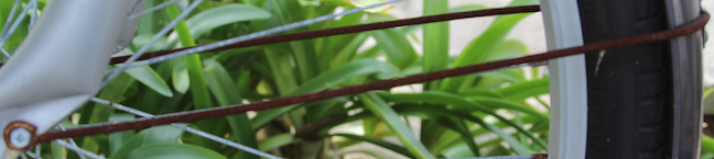

"Really, really bad" doesn't exactly describe it. Can you post a photo?

Yes, definitely. I'll try to, with my flash and DSLR. But it's really dark out right now. So if I can't get a good image to show how it actually looks, it'll have to wait until morning. (FYI, not home right now, but will be in a couple hours)

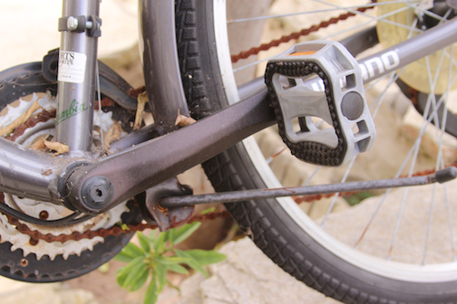

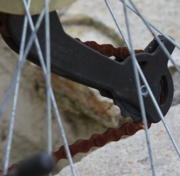

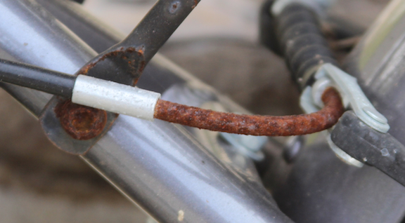

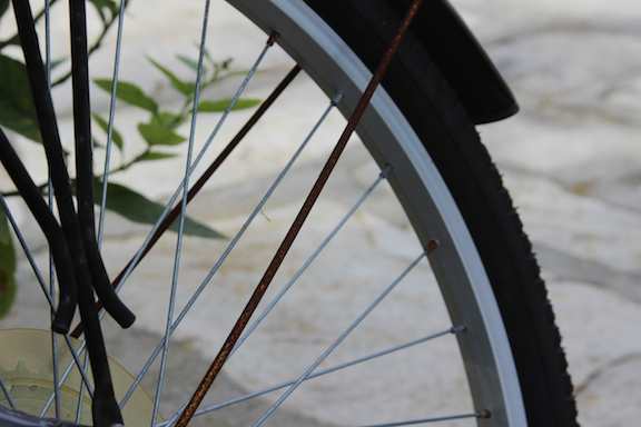

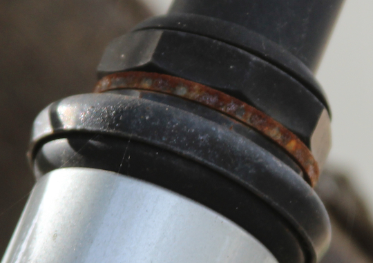

Here are the pictures that I promised. It's really, really bad. At least I think so.
Get a new chain--approx $20. New cabling--approx $20 (plus v-brake noodles which cost about $2 apiece). Oxalic acid on the rest. Don't let it get into the bearings. It will mess them up and your bike will make horrible sounds. It is NOT recommended to use old rusty cables. You could get into a crash because they have seized, rendering your brakes useless. Also ill-advised to do anything to remove rust from a chain because whatever you use will get in and destroy the o-rings that are there to hold the lube in place.

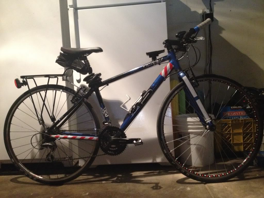

In my experience, Sports Authority's warranty is only good for parts. It has already saved me $60 on the rear wheel. I need my front wheel replaced because I crashed into a pole. I trued it so it is rideable, but I need Sports Authority to replace it because the spoke tension is very uneven. I'd say go ahead and take it to your LBS. Get a relationship with them. It should all be under $75 for repairs. They may even have some spare hardware to replace the rusted fender strut.

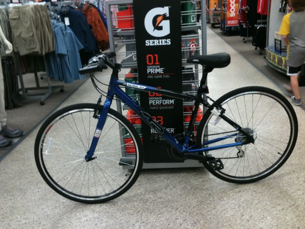

Edit: I really want to get a picture of my bike in here.
Day I bought it at Sports Authority:
As it stands now:
I replaced my tires, flipped my stem (to lower handlebars), swapped saddle, added a rack, bought different bar ends, wrapped bar ends in bar tape, got new grips, replaced cables with white ones (installed after picture was taken), added cyclometer, added iPhone mount, added handheld pump and bottle cage, bought clipless pedals, etc...
I think the only thing you need to buy is a new chain. The rust on the cable shielding is ok. As an extra safe measure replace all of the cables just in case there is some rust that has weakened the cables. Basically, bring your bike in for a tune up by somebody that knows what they are doing.
