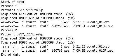

Well I ran the script, this computer has 10.2.8 and needs a lot of updates, but in process viewer i have 3 F@H processes running, I can't tell what protiens or % complete.
I am confused, nothing unusual about that, just have some extra tonight!

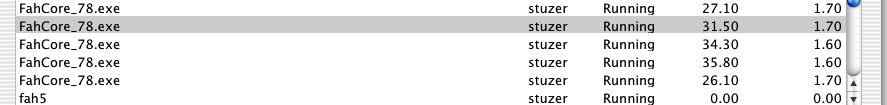

Like a smoker at a refinery, i tried some terminal commands from the read me, now I have 5 FahCore_78.exe running on the process viewer!
Ok, I really need help here. I am thinking that I should do a rid command and basically uninstall, but am not sure I understand the implications as stated in the "read me".
*WARNING* The command rid will remove .login and your user (not system) crontab.

looks like u started the process either by using start more than once
or
u installed it more than once
or
something else is going on 🙂
just use the rid command and try again. if u've never been in terminal before than this command's side effects won't affect you
if everything goes well u should only have 2 fahcores running. if not post again and we'll go from there

thankyou, here goes a run at "rid"
btw running 10.2.8 on dual 450 with 1.128 gb ram
edit: went in terminal, typed "rid" then responded "yes".
In process viewer there is no longer a F@H running.
will try another install. then type start once.
