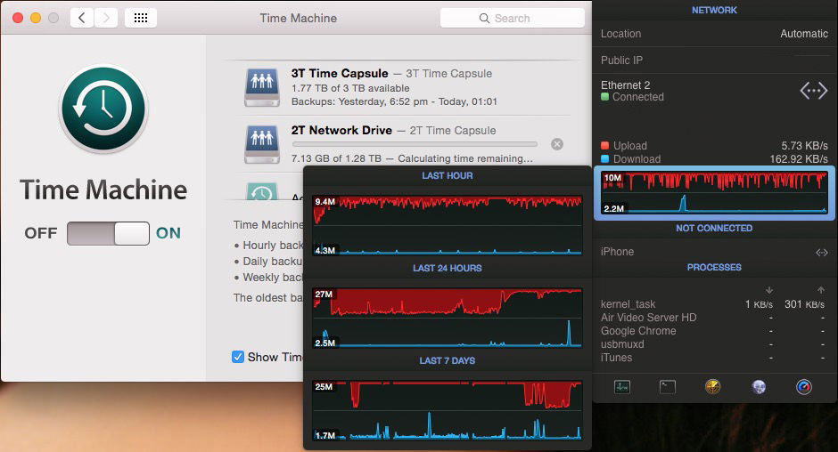

And this is the screen capture of the backup speed.
As you can see. The big red part (in Last 24 Hours) shows the 3T TC can finish a 1.3T backup in around 15hours, and the upload speed stay at around 30MB/s. However, the upload speed of the 2T TC is much slower and unstable.

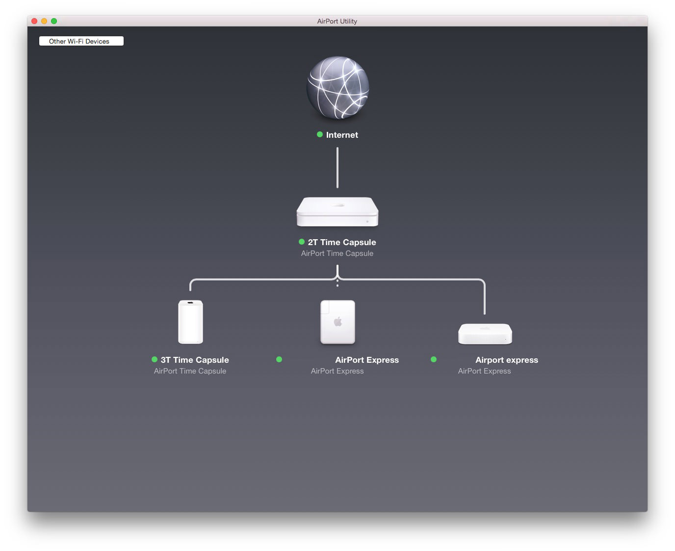

All the TC is connected via cable. In fact, the 3T TC is connected via the 2T TC (as follow).
So, if that's the networks problem. The 3T TC can't stay away from the problem because all the data feed via the 2T TC.

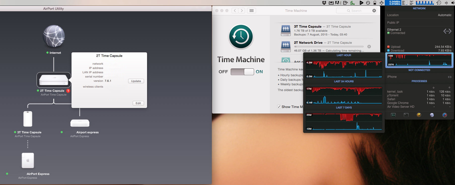

Back to the original config (the old TC as router with direct connection to the Mac) now + use 7.6.1 firmware.
And here is the result.
The TC start a backup with around 20MB/s, and then slowly decrease speed to around zero (The red triangle stuff on the Last 24 Hours area). This time it stops at around 46GB position.
My guess is that the Time Capsule is starting to fail as the units here do not exhibit any of those symptoms. Do you have AppleCare on a Apple TV, Mac, or iPad by chance? If so the TC is covered on that agreement provided it was purchased no more than 2 years prior to the date of the AppleCare agreement.
