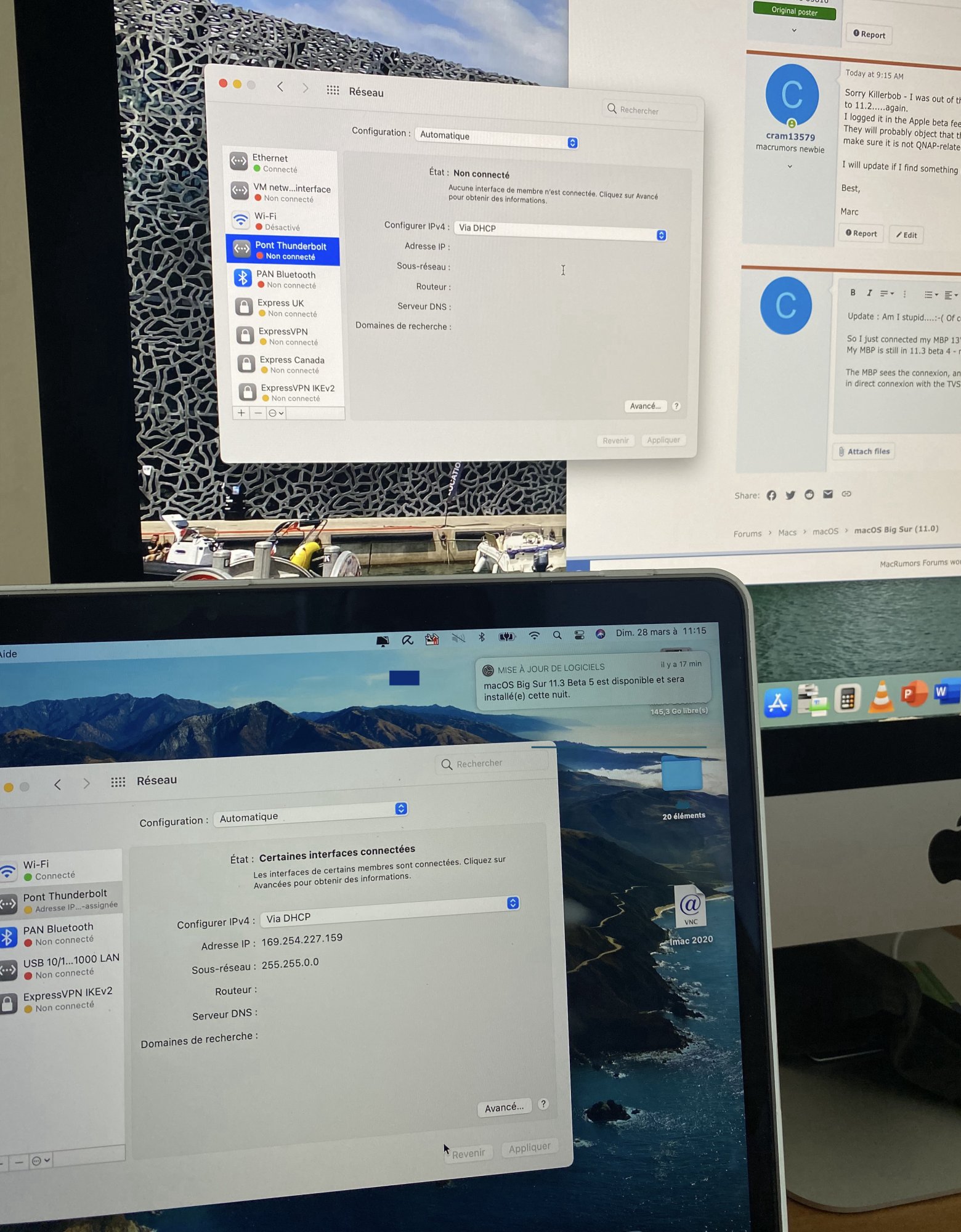

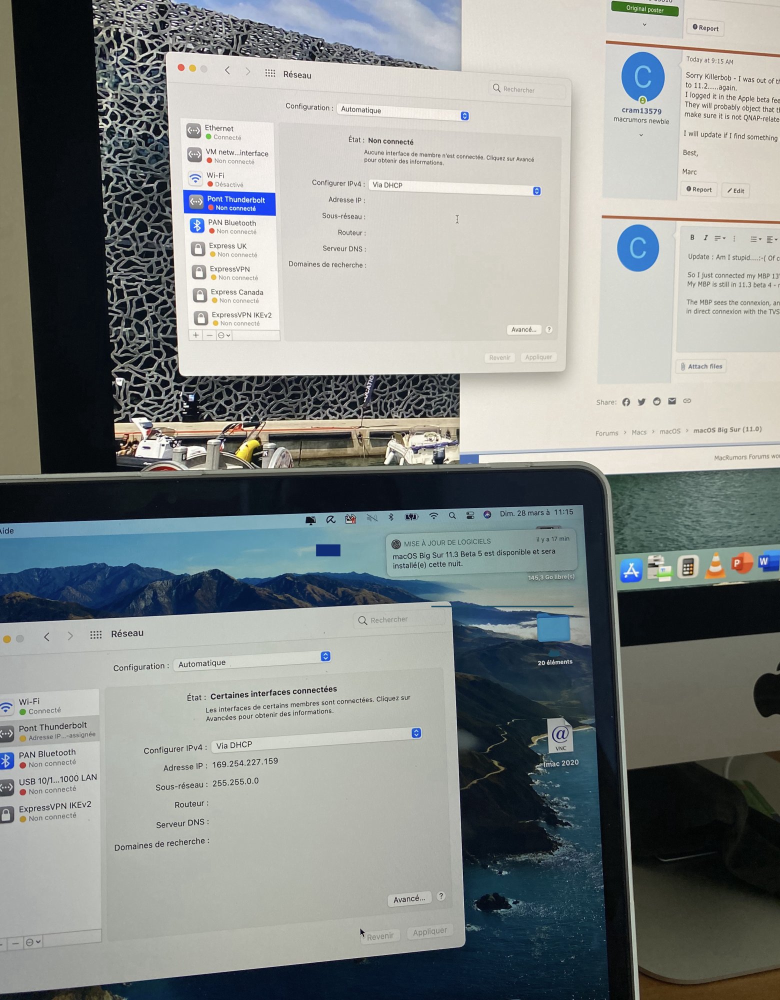

Update : Am I stupid....:-( Of course I have another TB over ethernet device : my Macbook Pro.
So I just connected my MBP 13" 2019 to my Imac 2020 directly by a TB3 active cable.
(My MBP is still in 11.3 beta 4 - my Imac is .....back to 11.3 b5)
Surprise : The MBP detects the connexion, and takes a DHCP local address.....but the Imac 2020 remains red, on the other side of the cable (picture attached).
Anyway, and after testing the MBP in direct connexion with the TVS-872xT, it does not work either - behavior similar to the Imac.
That is something....
More to come - I hope,
Marc
