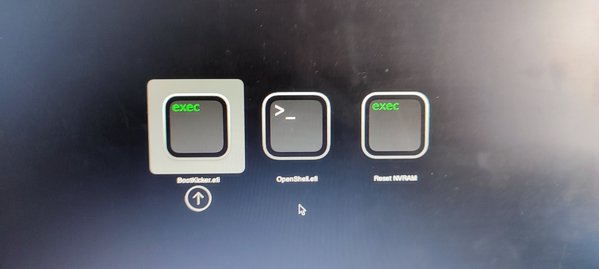

i installed Big Sur on my 5,1. It is all working fine, so the first thought was to CLONE the disk as a backup. So I copied the disk (using third party software, as Disk util did not want to)
Now I ran OPen core and added the boot the the EFI of the backup SSD.

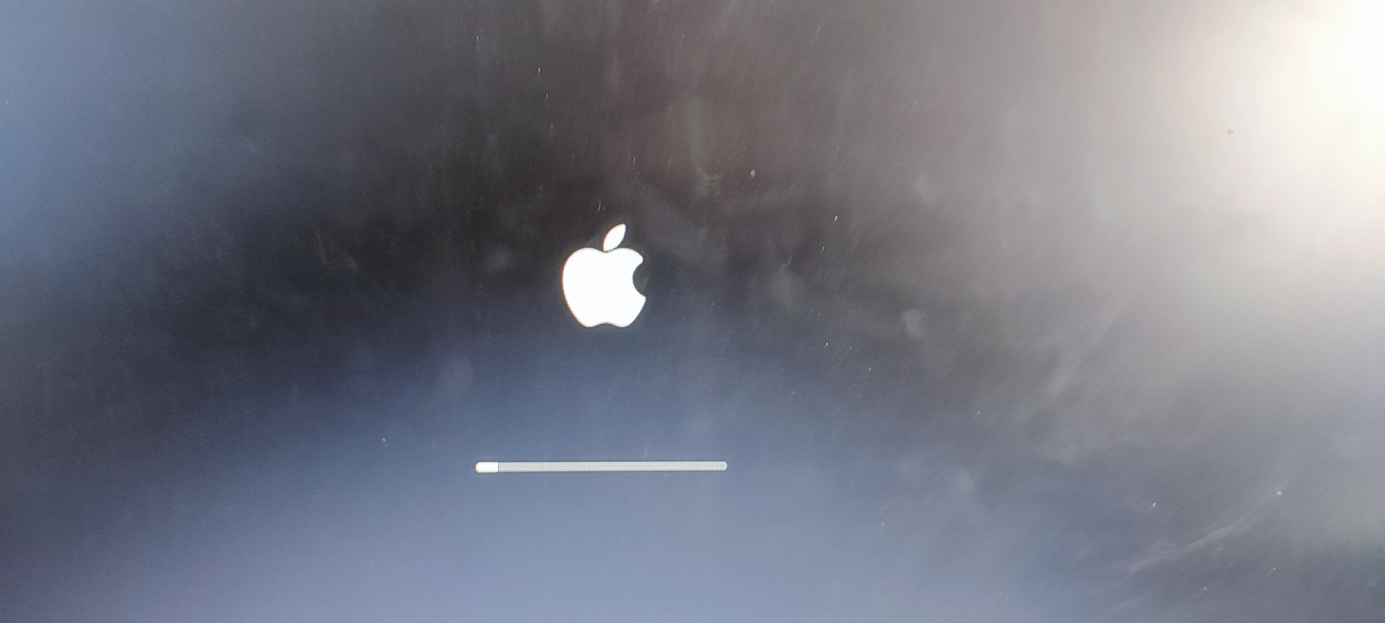

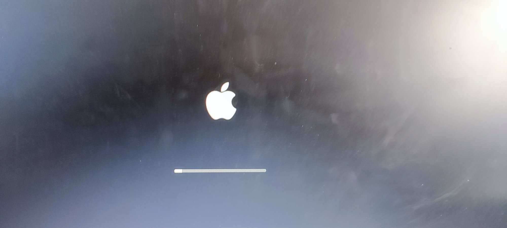

I removed my original drive and booted the machine. At the boot select screen, I selected EFI partition, then selected my backup disk. The apple logo showed, and the loading bar went, for about 4 seconds then stopped. it sat at this point for about 30 secs and then the screen just went off. the Machine is still powered but nothing is showing, so I assume my clone is not working
What am I doing wrong, to clone a disk which has Open core?
This is as far as it gets then the screen goes off
As it's a HDD I'm backing up to, I can still hear it chattering away but noting is on screen

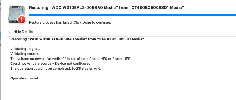

I am still having issues, where I just cannot backup my main drive
main drive is a SSD 480GB fitted to slot 1.
Second drive is a HDD 1TB fitted to Slot 2
I have tried Disk Utility, and I get the error attached
I used a third party clone software, and it copied ok, but on boot, it simply will not boot on the 1TB HDD
any idea how I fix this. I want to backup my drive as a bare install, before I commence installing apps etc
thanks

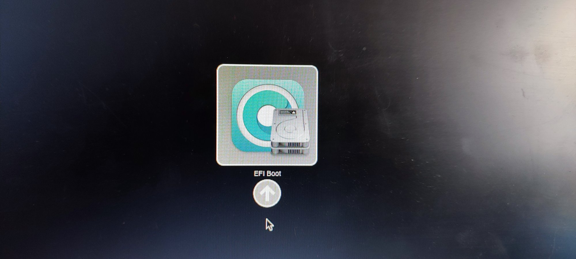

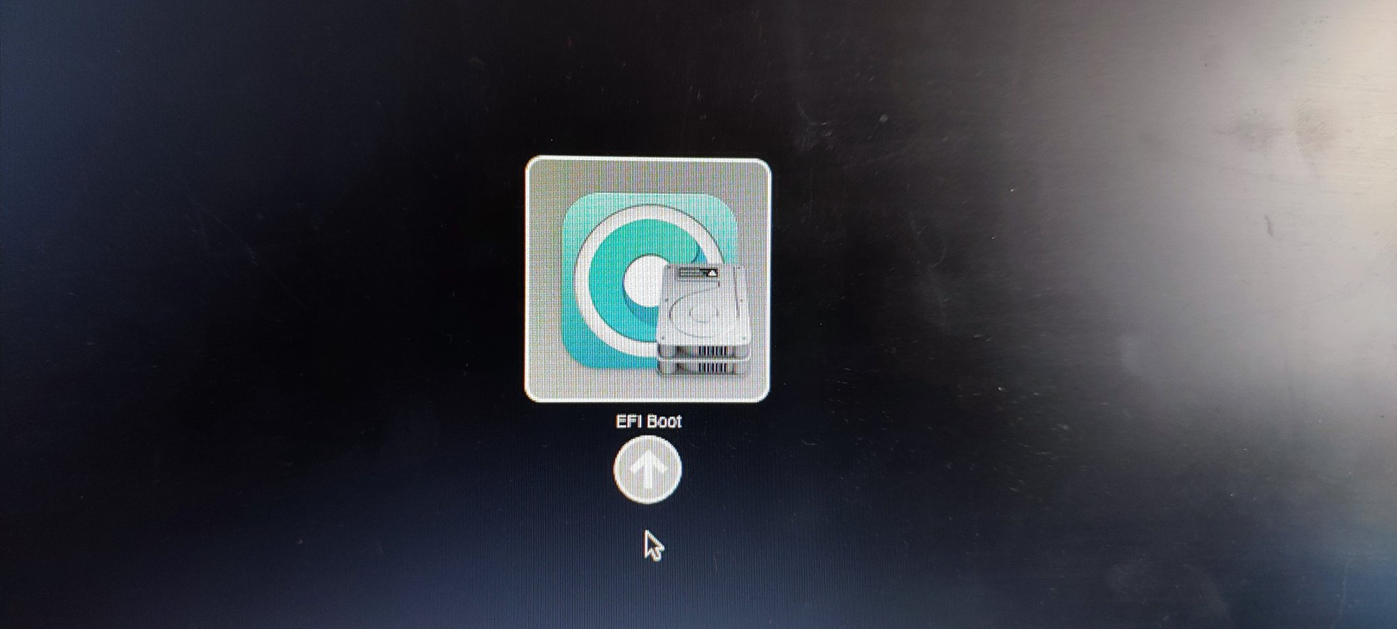

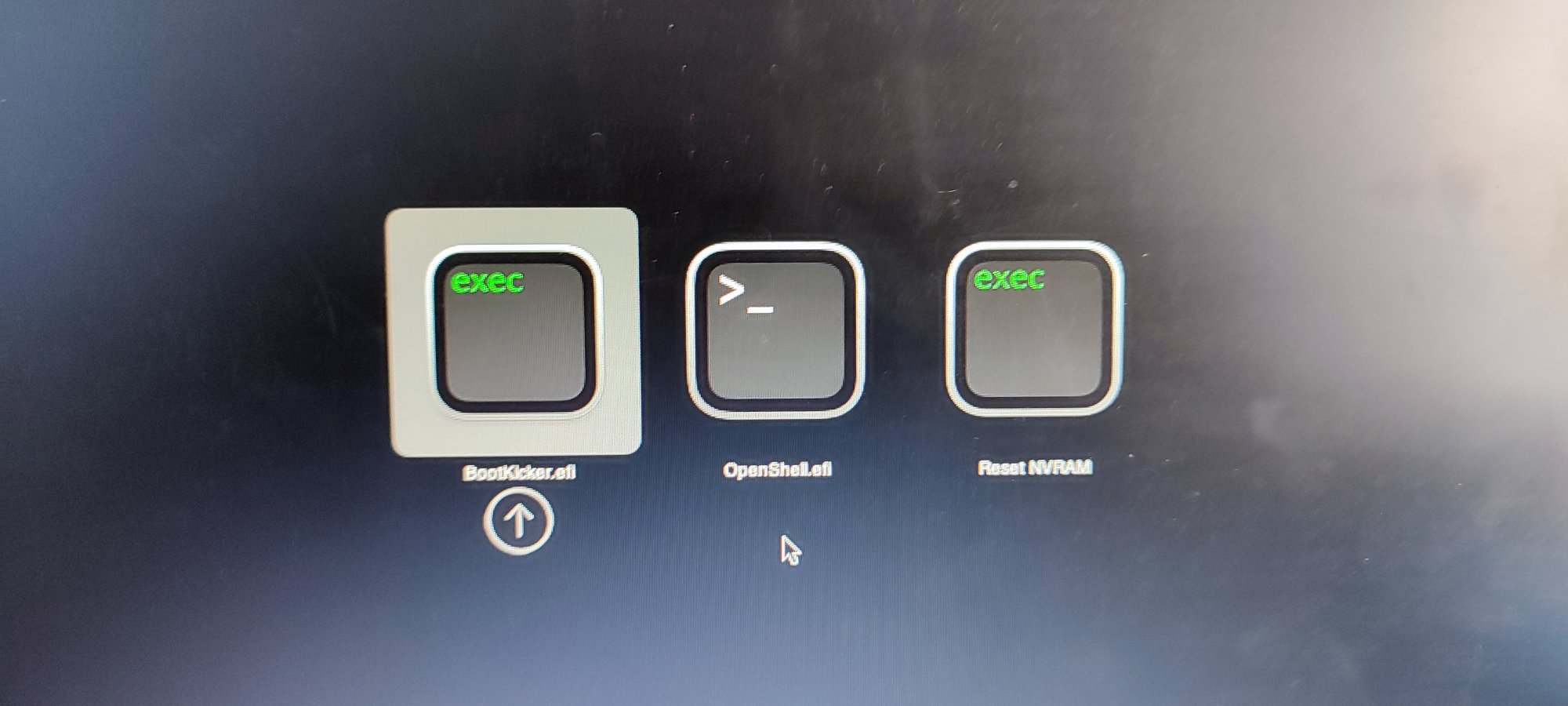

I tried that yesterday, and still no luck. it copies fine. Shut down machine, and remove original drive, and boot from cloned drive
I get the EFI boot screen, but then no OS to select
