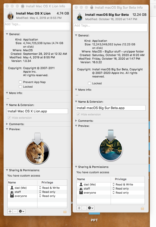

If I copy this installer from my application folder after download to another storage disk the copy is ok but then I get a file with a forbidden sign. And yet these 2 files have exactly the same number of bytes (attached image).
If I copy back this distribution from the local disk to the Applications folder, the forbidden direction does not disappear.

One thing I did notice is from your first post. The Get Info windows for those two Big Sur installers show different permissions, and neither is the same as the permissions that all of my OS X installer apps show.

Here are 2 installers having the same permissions as yours.
One is fine, the other is not...
