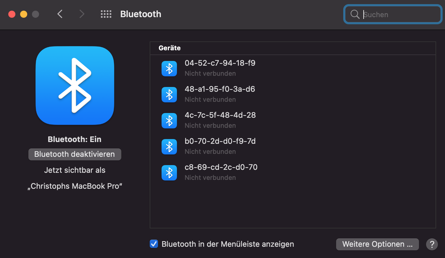

Hi,
it doesnt work. I was already trying something similar (see my first post) and did it again. After I was disabling bluetooth and moving com.apple.bluetooth.plist to the desktop, I did a reboot. Back on the screen, Bluetooth was already activated by itself. There were 5 devices without a name listed. 3x headphones, 1x speaker, 1x iphone..

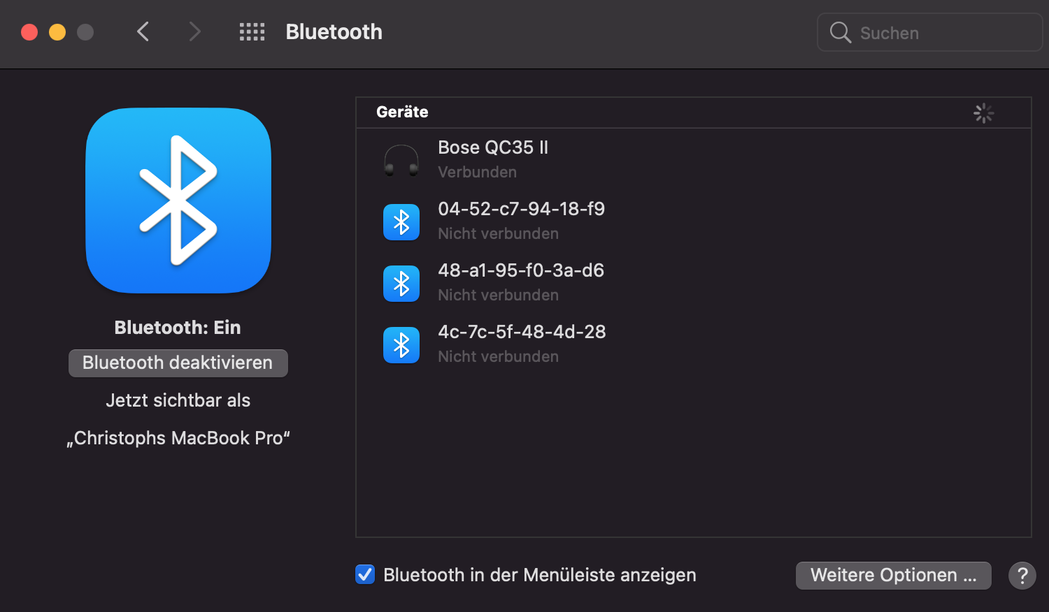

I set my QC35 to pairing mode, one of the IDs changed to the Name (and one ID is not listed anymore, it was my iPhone). I can connect to the QC35 but just for a few seconds..
... And than: connection lost. Moving com.apple.bluetooth.plist to the desktop, deactivating/activating bluetooth, rebooting, and resetting bluetooth module did not work for me.
