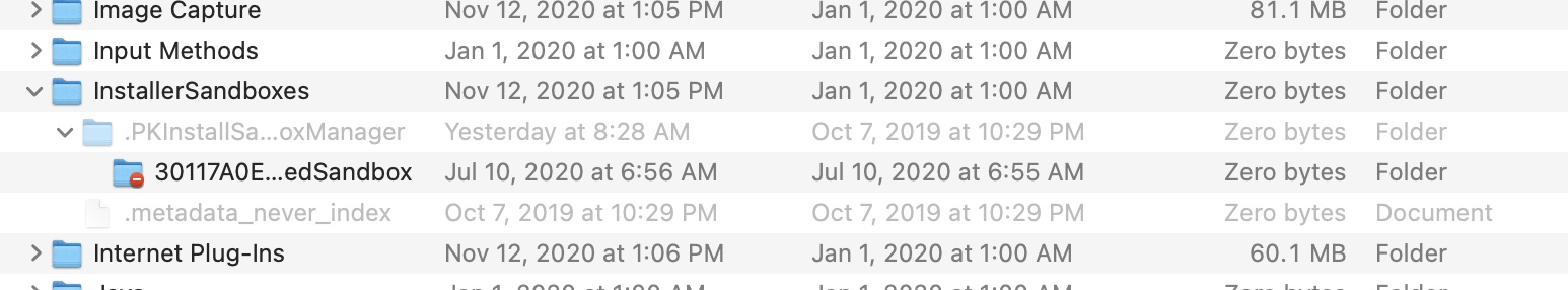

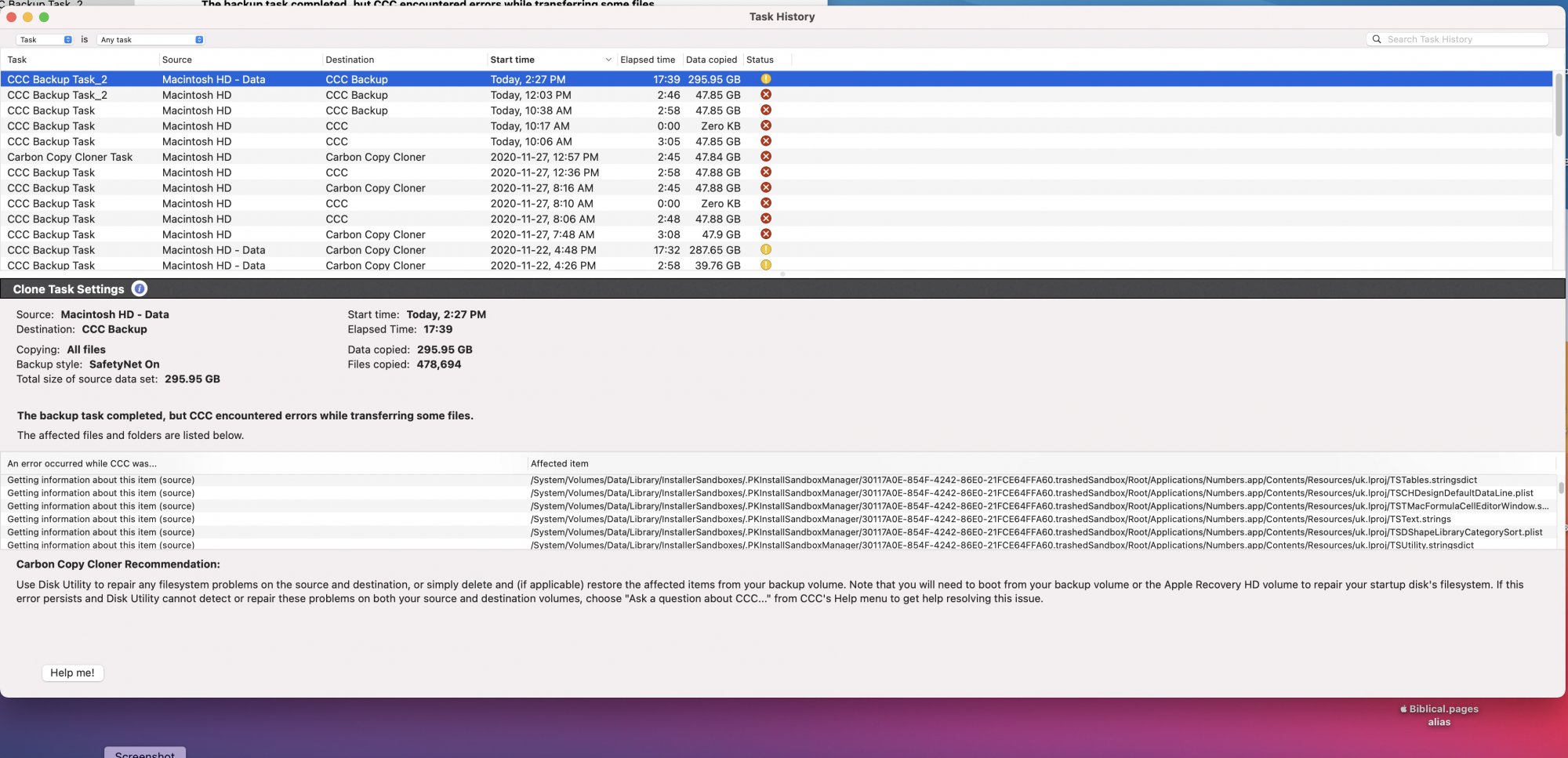

Tried to run Carbon Copy Cloner and it wouldn't clone because of these files. Drilled down to the folder with "show hidden folders" and I can see the last folder is red. I did do a Data Copy with CCC excluding this file and was successful. I want to do a clone that will allow to boot from the cloned drive.

The two Macs I have here which are on Big Sur have no files in that directory. They are not likely required to make a bootable clone.
I can't open that file either, but do see a red marked folder. When I run CCC this is what comes up. So I know that there are problems in that folder.
