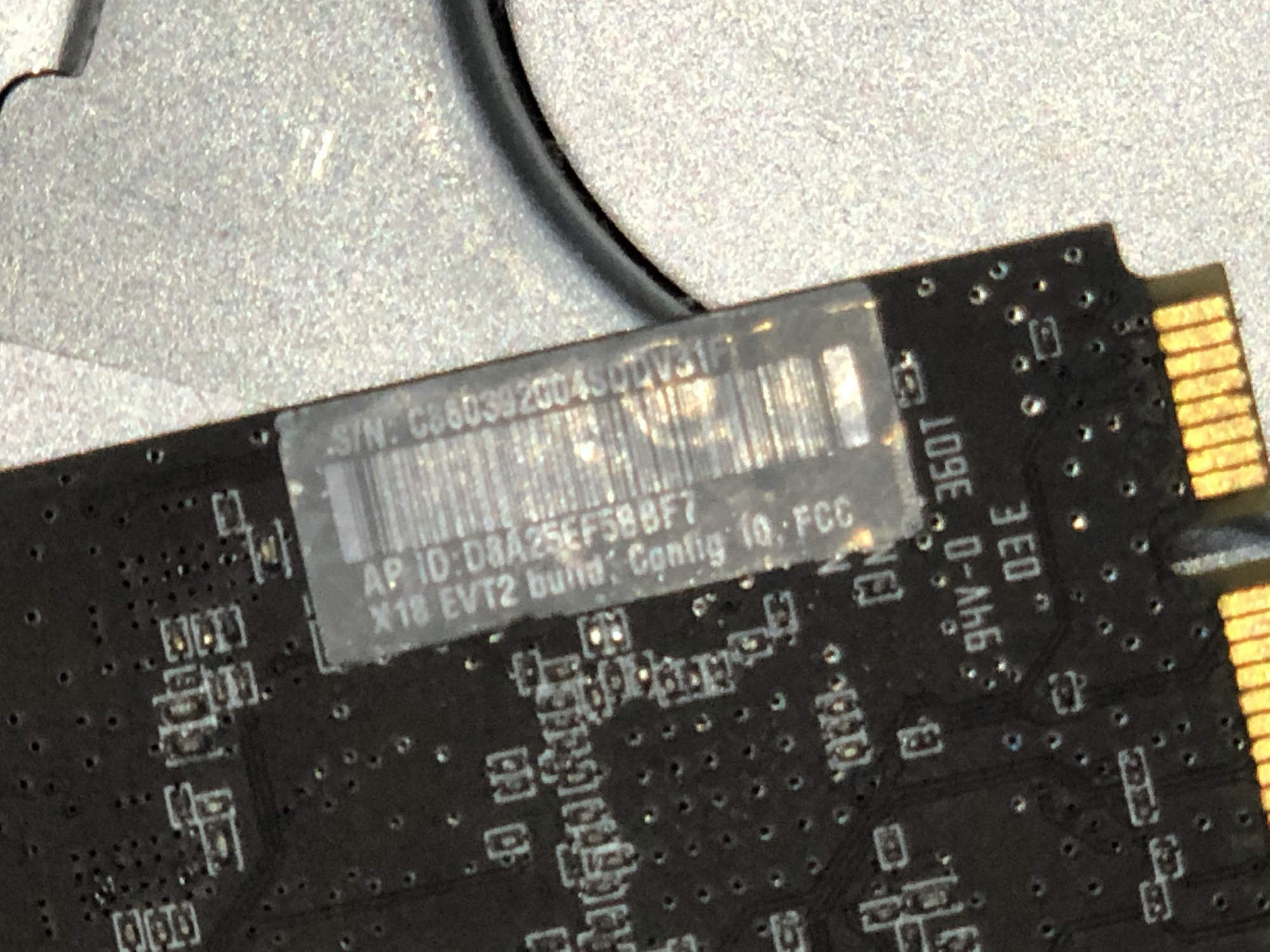

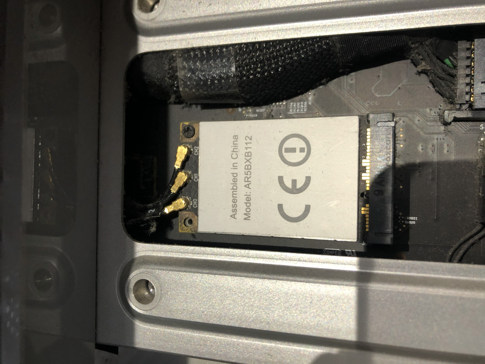

I've gone from freshly installed Catalina (all working fine) to Big Sur with OC and now my MacPro 5,1 won't recognise my wi-fi card (model AR5BXB112), do I need to buy a different card?
I have tried the config file edit Martin Lo suggests and tried OC 0.6.3 wifi fix but nothing is helping.
See attached images of my current card.

Apple removed Atheros AirPort Extreme support long, long ago.
You need a BigSur native supported BCM94360CD card, see the upgrade thread below or if you want to do it on the cheap, buy a BCM94322MC and then install the kext for it. I'd go for a BCM94360CD, 802.11AC, BT4.1 and BigSur native support.
