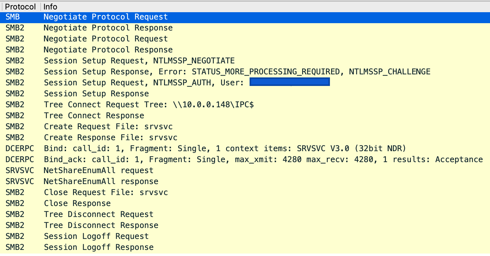

When I query the shares and monitor network traffic, it's pretty easy to see how it's being used. (It appears to be superficially the same on Catalina and Big Sur.) The most significant thing is that it is opening the "srvsvc" named pipe and using it to send the "NetShareEnumAll" request (which lists the shares).
The IPC$ share can always be accessed anonymously, but the srvsvc not so much (according to that link). I see that when I list shares, I am NOT connecting anonymously; I see my user id being presented for authentication.

I had two people send me logs, but I've yet to get any takers on providing a Wireshark trace. Here's what I see in Wireshark when I successfully list shares
Each entry can be expanded to reveal a ton of info. There might be private information there that I shouldn't see.
One person's logs clearly showed "Looking up shares with RPC failed api_status = 1728". (That's the DCE RPC over the srvsvc named pipe using the IPC$ share.) Microsoft identifies 1728 as a "RPC_S_PROTOCOL_ERROR". I suspect the entry in a Wireshark trace where Windows returns the 1728 has more information than the console log is showing.
The other person's logs seemed to just get no response from the NetShareEnumAll (well, at least the Mac logs show nothing). It would be good to know if Windows did or did not respond in a network trace. If it really didn't respond, then a trace on Windows and inspection of the Event Viewer there are probably good next steps.

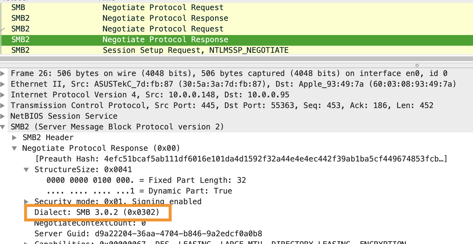

You can see the SMB dialect negotiation in the Wireshark trace but I'm not quite sure how to find that in the Mac's console log. Perhaps someone having the problem will run Wireshark and report that.
Big Sur offered my Windows machine 2.0.2, 2.1, 3.0, and 3.0.2. Here's what that looks like in Wireshark:
Windows chose SMB 3.0.2. And, here's what that looks like:
